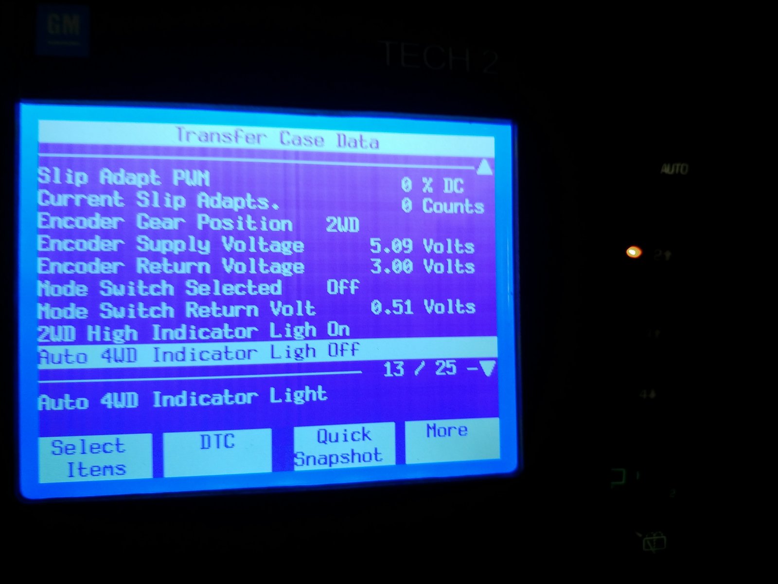

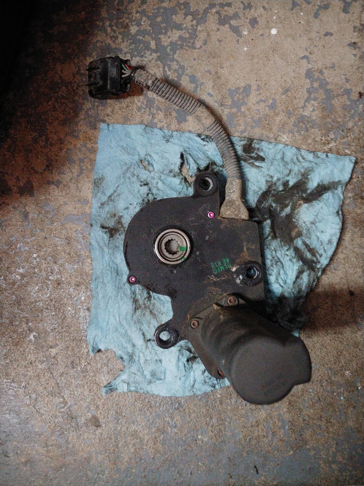

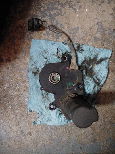

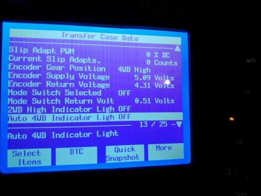

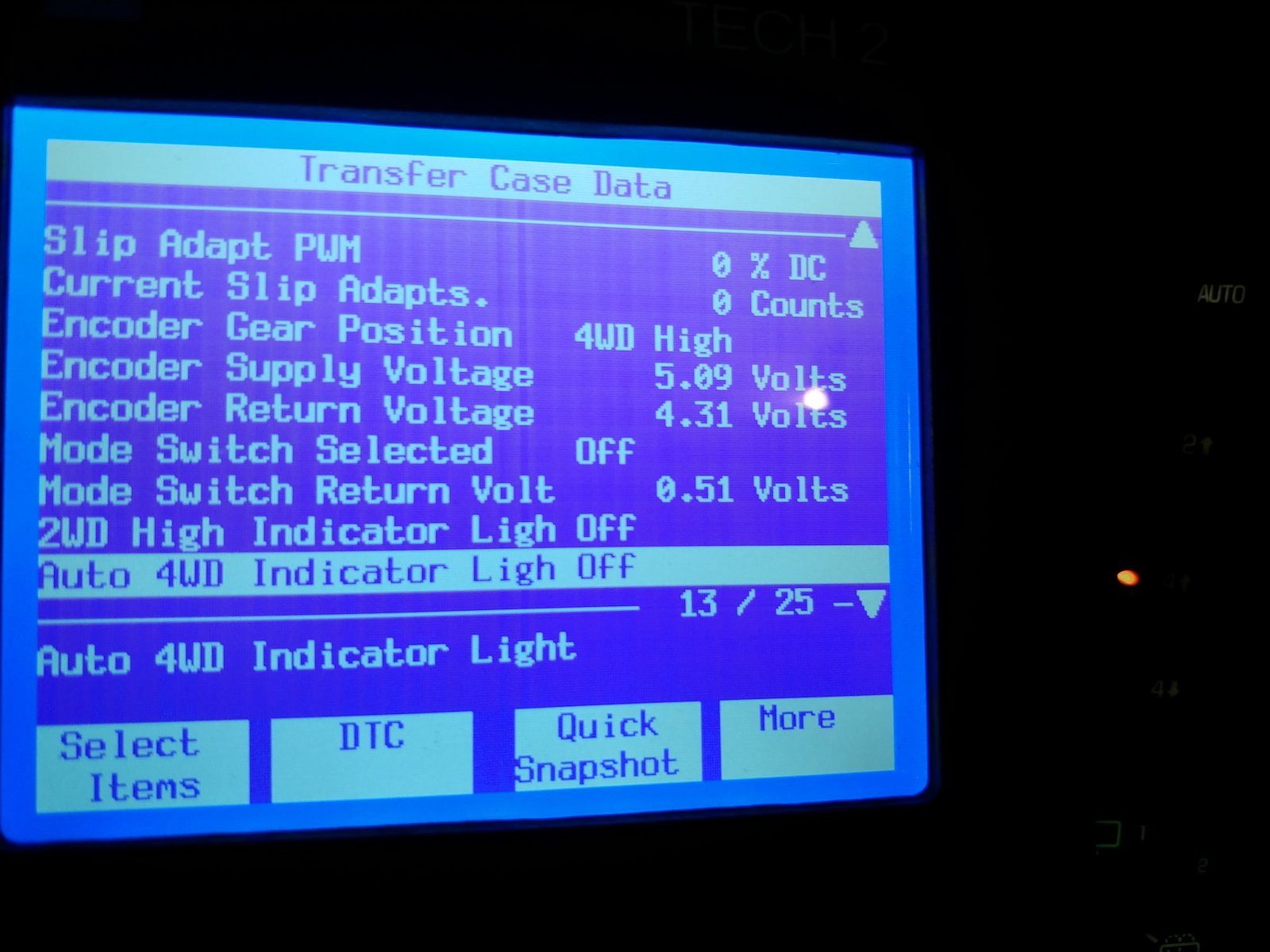

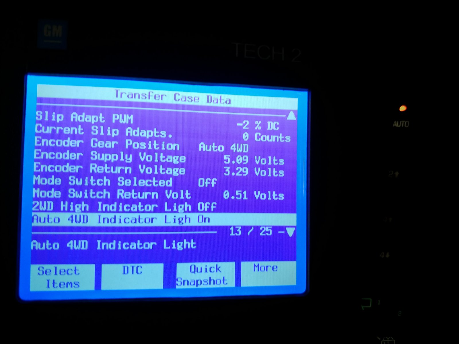

Alright! The encoder motor I bought from Amazon was only $106 all in. That fixed it. I'm pretty sure the encoder I removed was from a junk yard, as all the external screws were painted pink. I also took photos of the encoder return voltages after the new one was in. More photos in the next reply.

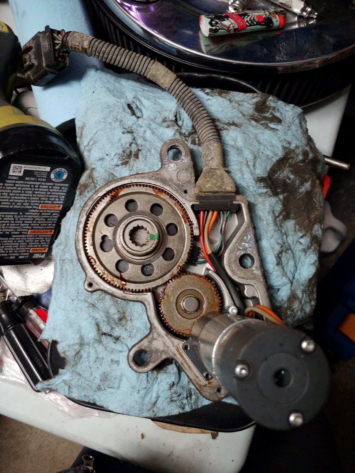

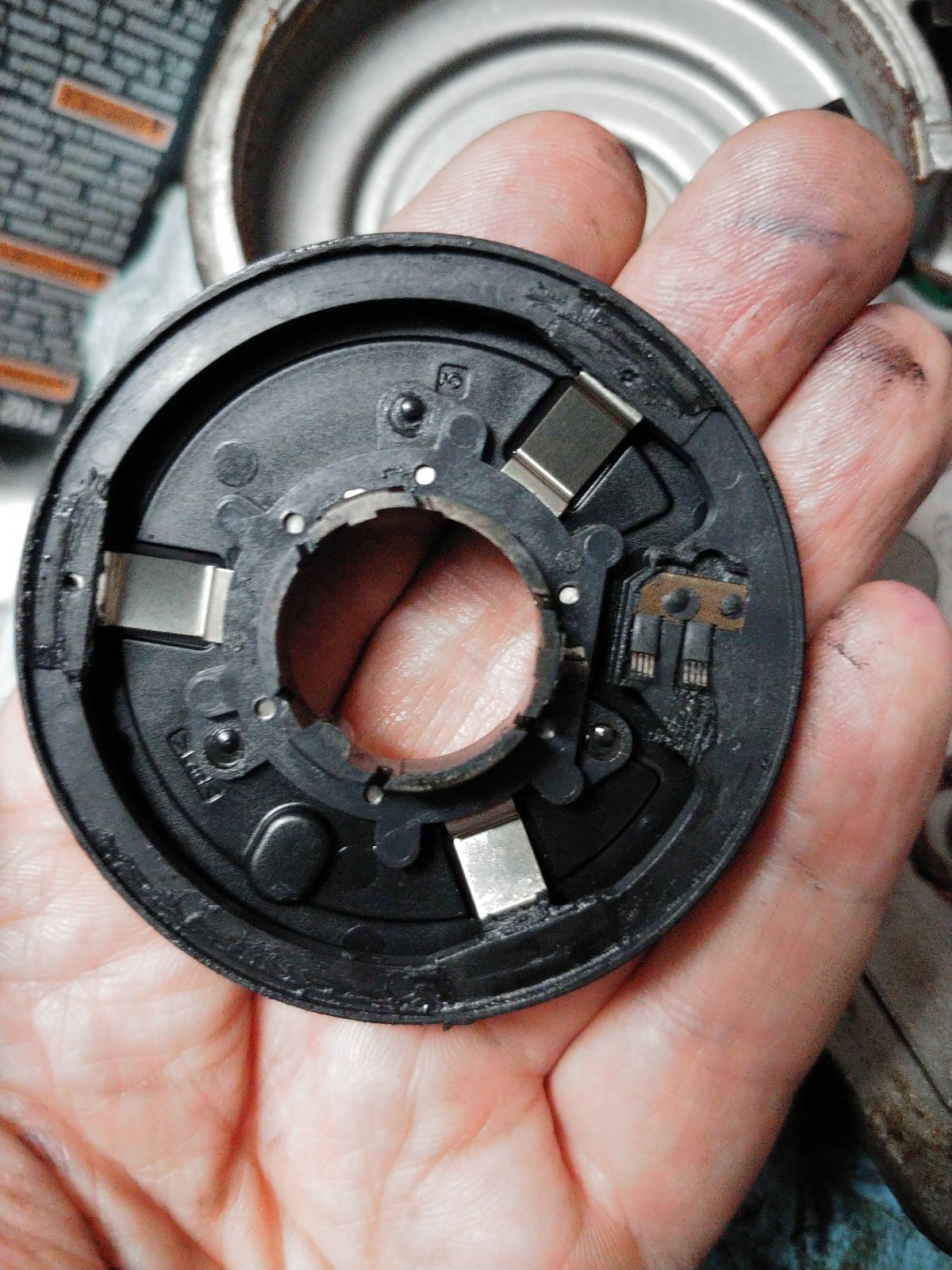

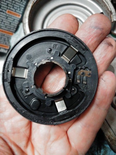

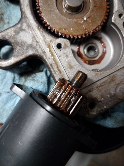

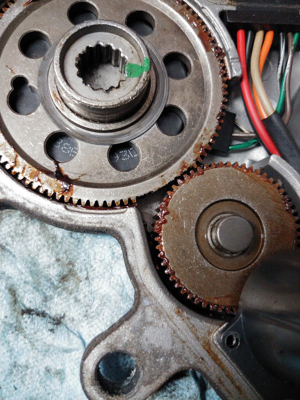

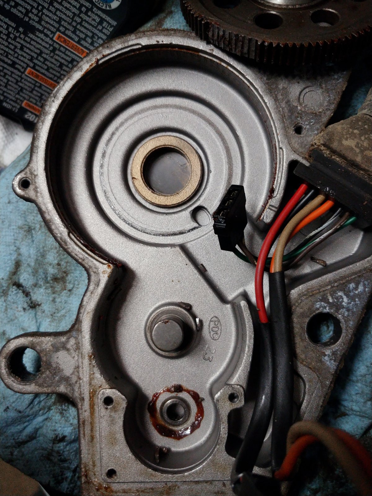

Internal photos of the encoder:

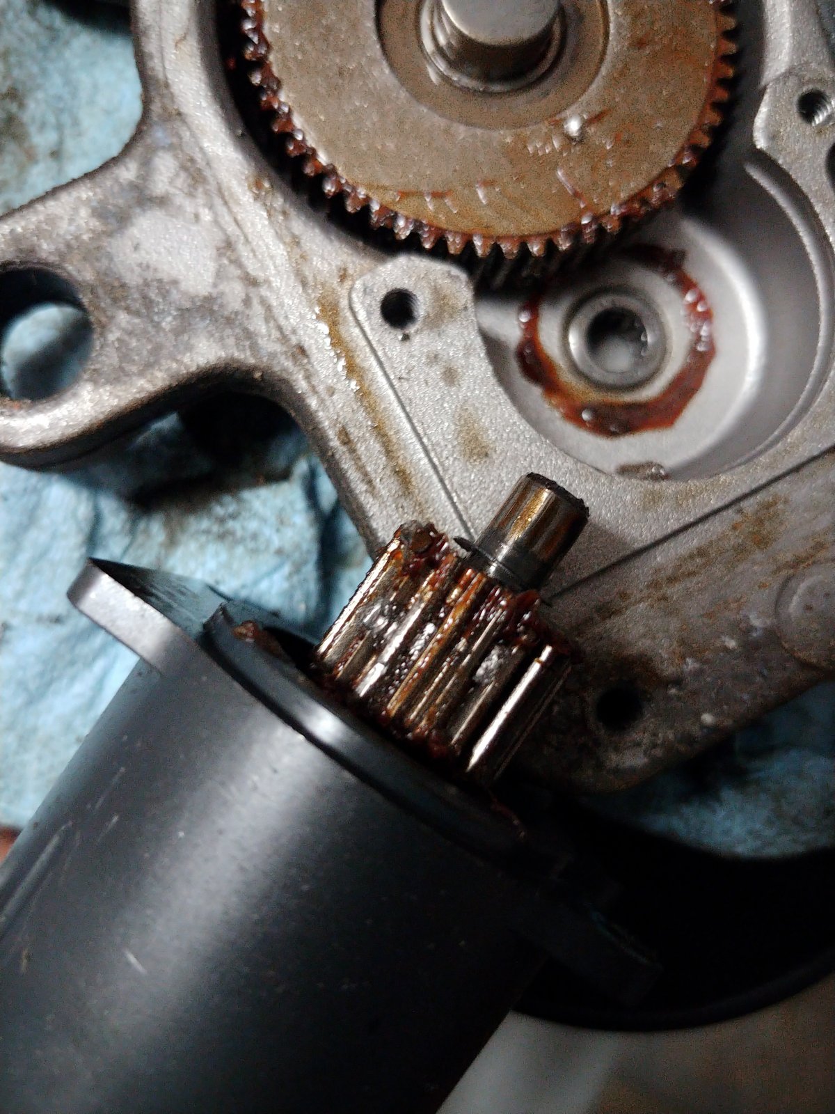

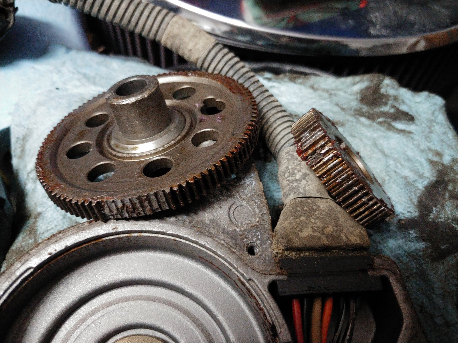

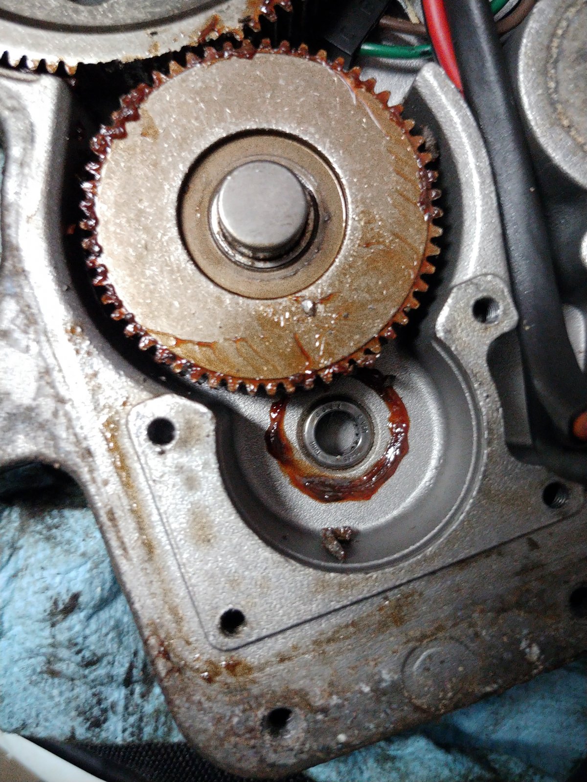

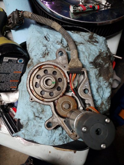

It looks like the encoder sensor is just fine, same with the motor, but all three gears are damaged.
