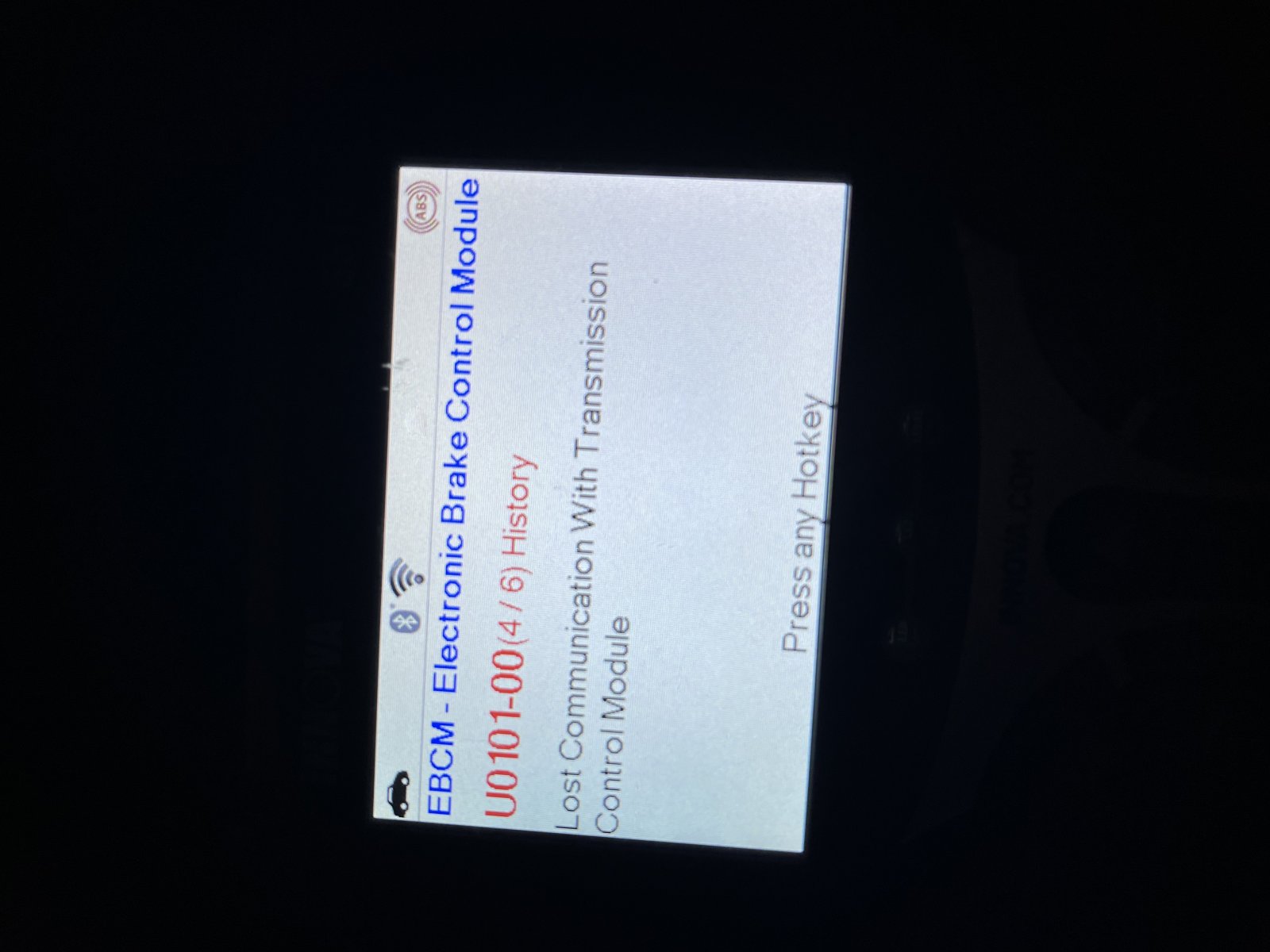

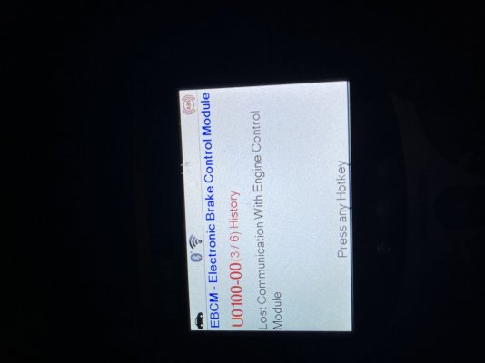

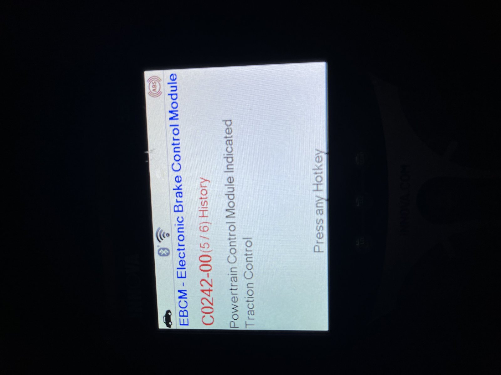

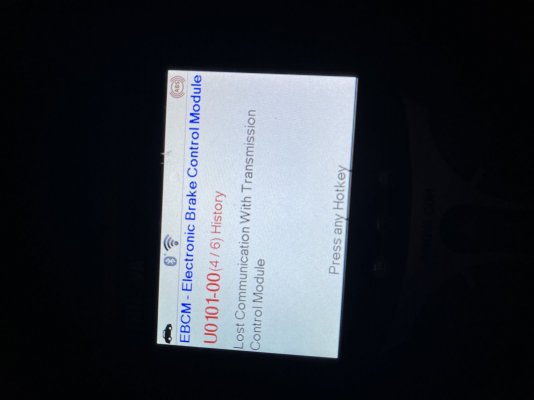

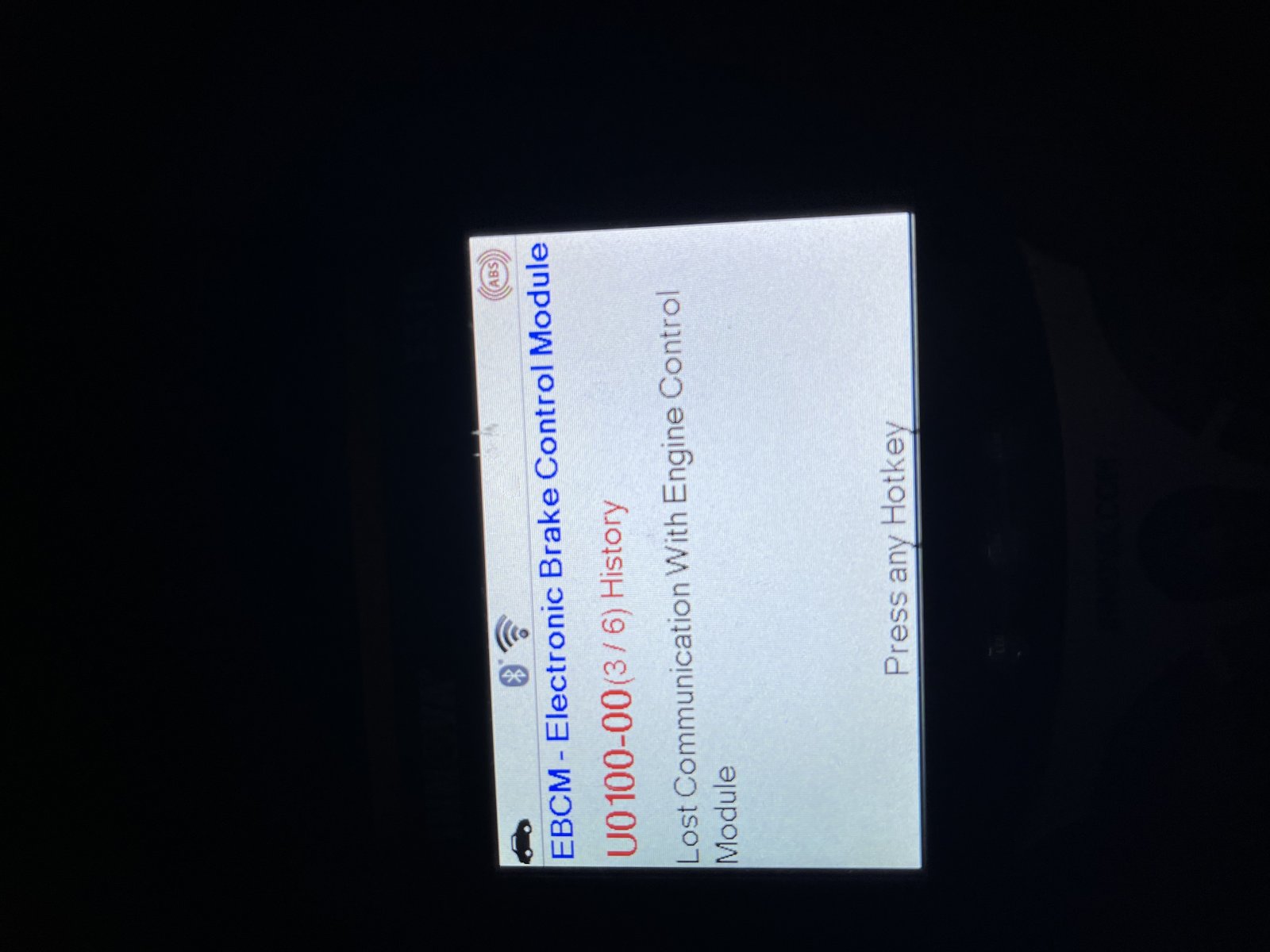

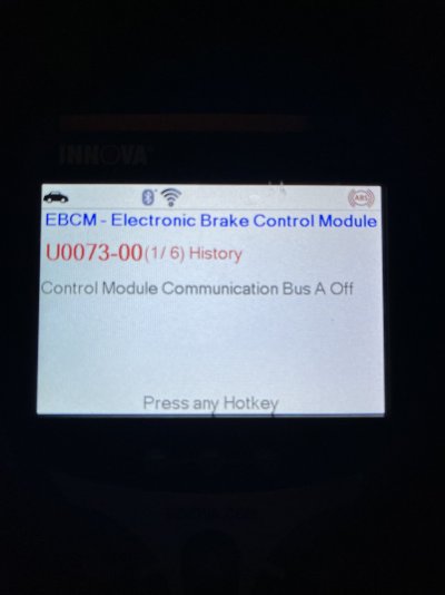

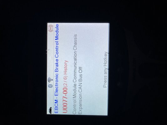

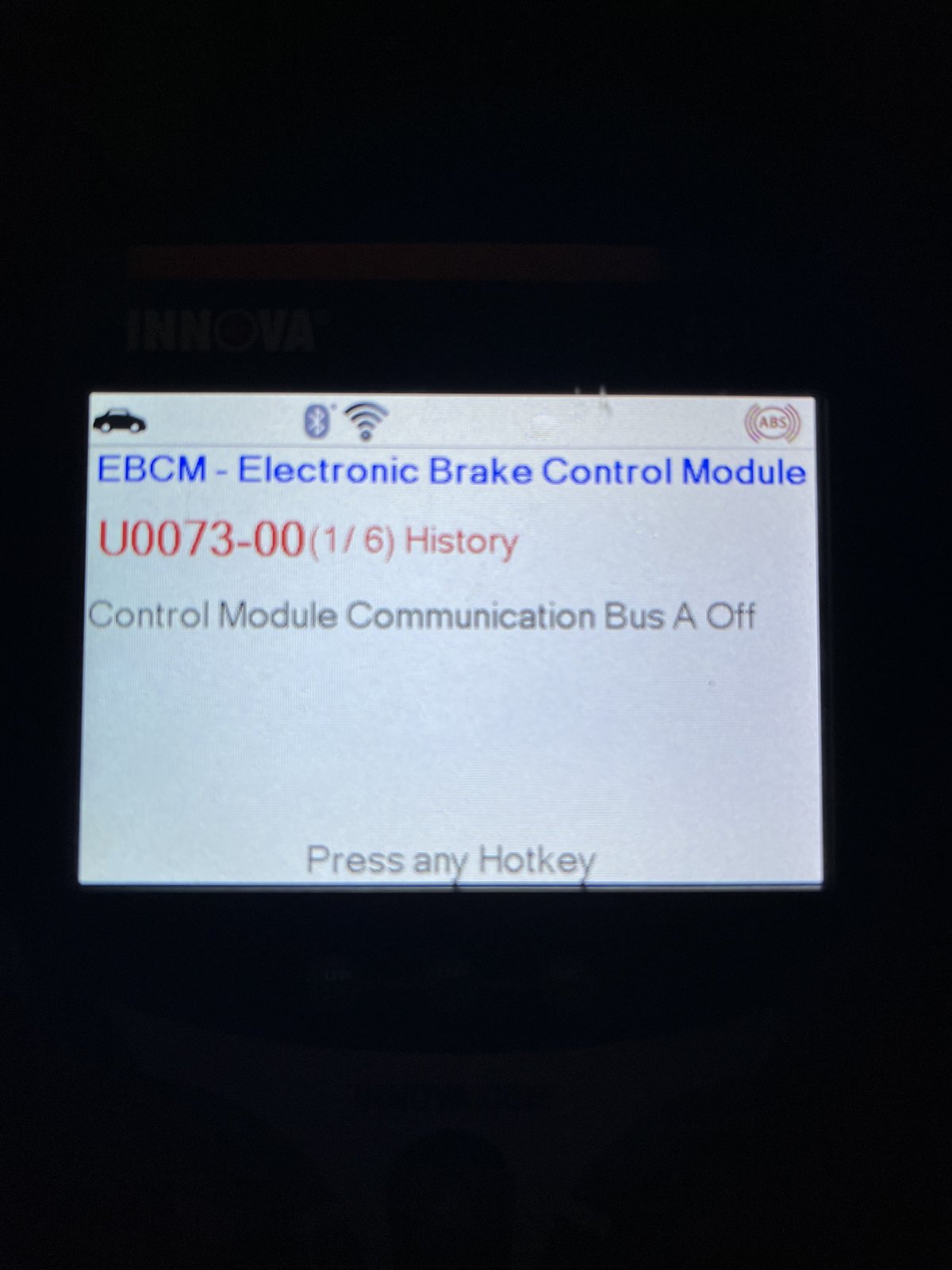

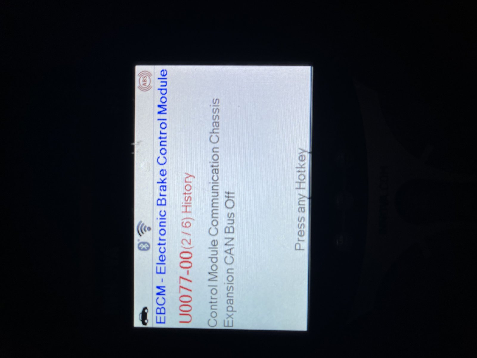

I have a 2015 Tahoe and when it rains I get no crank no start and a whole bunch of errors come up on the dash, I can sometimes get it to start in the rain after fighting it for about an hour. I attached some photos of the codes I got from the scan, also a video of what the truck is doing. If anyone has a solution it would be much appreciated

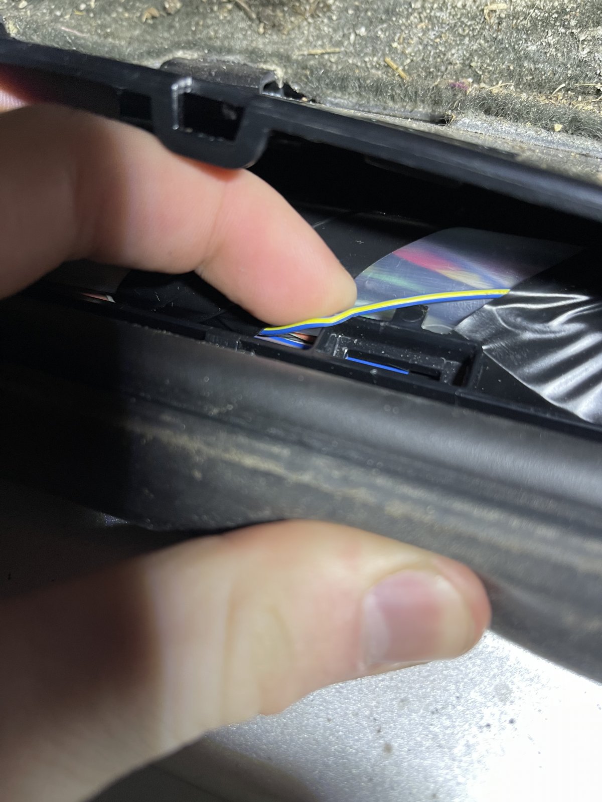

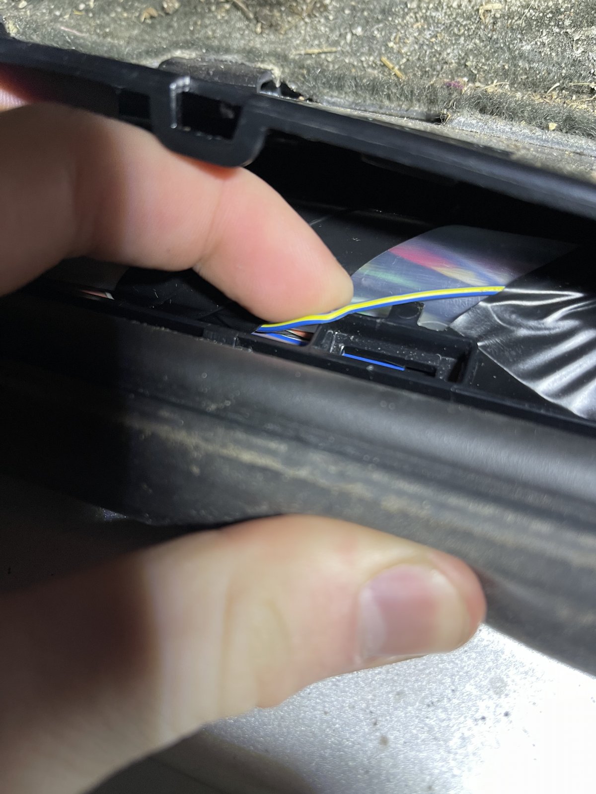

Well I found the problem under the kick panel on the driver door side one wire was being pinched.
