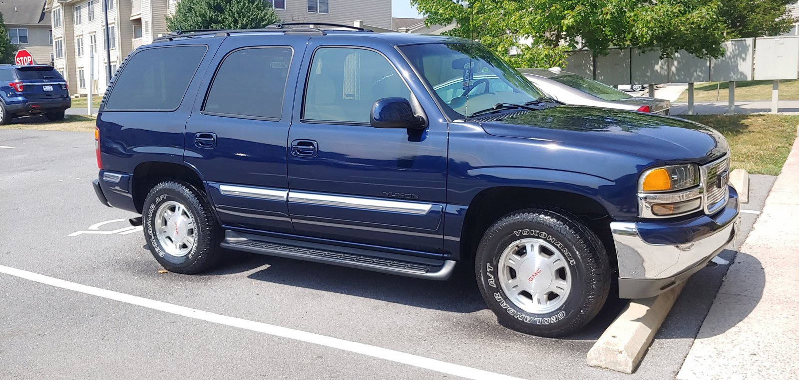

no ac on dashboard vents just blows in defroster
Jun 14, 2020
68
71
hi, I got no ac on my 2001 GMC yukon6 slt 4x4 dashboard vents just blows in the defroster and on ceiling vents. still very cold. any ideas? thanks
