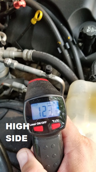

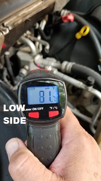

Well of course my A/C goes out the week it's 90 in Michigan and could hit 100 today. Last month I used 2 cans of r134a and my air worked fine. Well it's quickly dying and now is blowing warm. The compressor turns on so I know there's a couple pounds in the system. I do not have gauges. Well, I went to put some freon in the system and I noticed that on the low side the tube was COLD and the other side of the connector on the high side the tube is HOT.

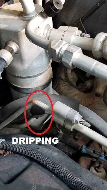

I also noticed a drip, which could be condensation since it's humid out. I swear I hear a hiss or leak, but it could be my mind. I don't want to put more freon in the system if it doesn't need it and something is plugged or leaking?

Temperature directly relates to pressure. High pressure equals high heat and low pressure equals colder temps. Condenser is on the high side so condenser will be hot, the evaporator is on the low side and should be cold. That being said the the 81 degrees your getting should be WAY lower than that. High 30’s low 40’s approx. and the high side should be approx 220 ball park.

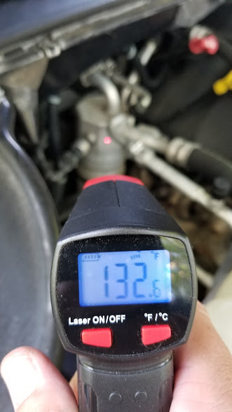

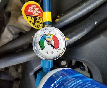

Well the cheap Walmart gauge told me it was full. So I didn't add any. Earlier I checked the condenser and it felt cold, but after 2 minutes it heated right up. So my system doesn't leak, something simply isn't working properly.
View attachment 202712 View attachment 202713
Well what you’re pointing at is the accumulator and that lil fella should most definitely NOT be anywhere close to 100 degrees unless your system is not even on and that’s ambient temp.
That’s just a lo side. With a good gauge set you can see what the readings are with the system running. What about high side? If you had to add 2 cans as stated, there’s a leak. If there’s no leak, then you overcharged it. There’s multiple reasons why ac won’t work. Electrical problem like relay, pressure sensor, compressor coil, faulty hvac control unit
Mechanical, compressor clutch, seizing compressor.
