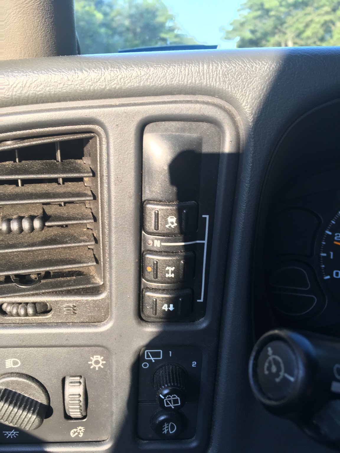

Can you take a picture of your 4x4 selector? I've never seen one that doesn't have a 2WD option. The Denali's were/are full time AWD, but they don't have a selector, there's no Low range option for them. Just always-on AWD.

Should look like this. If it's something different, someone maybe put the wrong switch in it.

I have the same in m '03 Yukon. Do you have an owner's manual for your truck? My owner's manual specifies that we have the AWD model with Stabilitrack based on the switch.

Well lookie there. I actually wouldn't hate having a low range in my Yukon....

It's an awd model no 2wd selectable .my buddy had a 04 that had same selector and it was awd

My 05 tahoe is the same.
