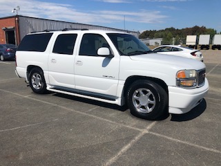

I just purchased a 2002 Yukon XL Denali. One of the previous owners thought the best way to lower the suspension in order to help an elderly person get in and out of the truck was to deflate the autoride by pulling the **** fuse and remove the coil springs in the rear. When I purchased the truck I was given the rear coil springs.
I am planning on putting the coil springs back under the rear and changing the autoride over to a passive suspension since the main purpose for the truck is to drive to and from work and I don't tow anything with it.
My question is with the front having torsion bars am I looking at having to replace anything besides the shocks in the front to be able to get the front end back up to the correct ride height?
I have never had a vehicle with torsion bars.
Thanks for any advice...
