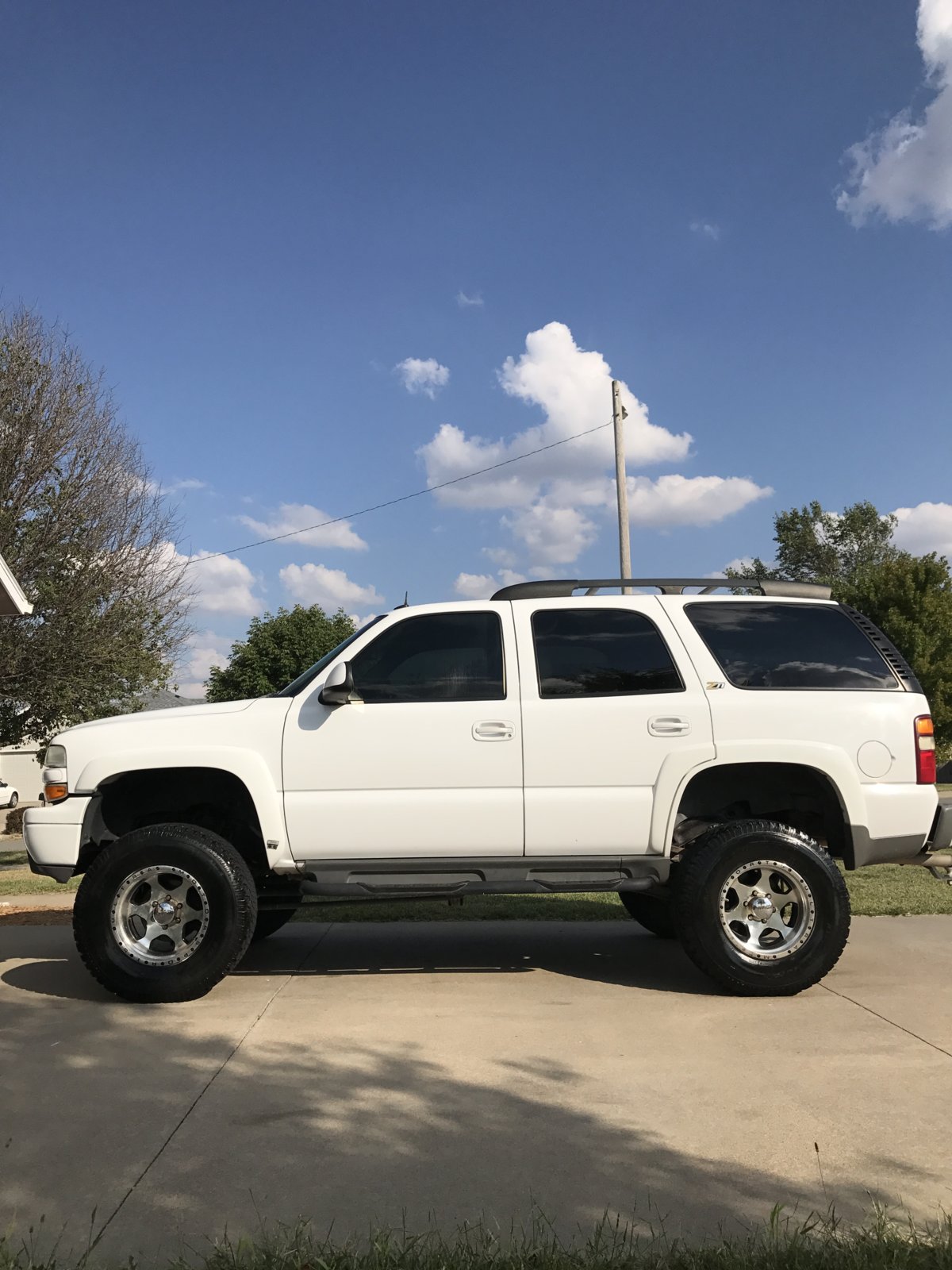

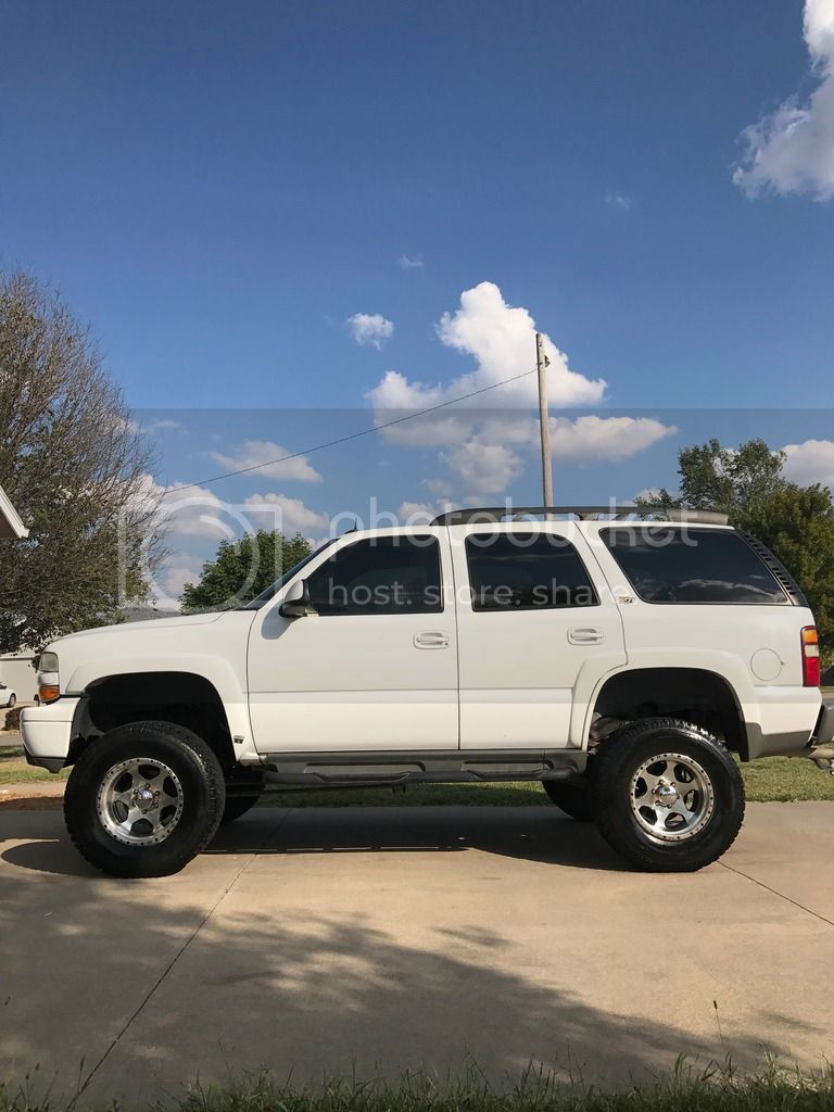

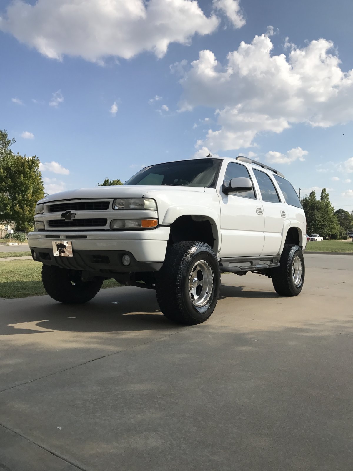

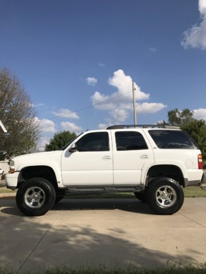

Here it is, Trying to find a HD hood is first on the list then hoping to to heads, tails, with LED switch backs. Anything anyone else can give me tips on??

The only thing that bucket is good for is... well I'll give you a hint, it's not photos!
How do you upload pictures? I haven't been on forums in forever and just tried the way I used to do it

Nice! A couple plastic trim pieces short but hell if you want to keep that look and can't find them... let me know I still have mine from when I took them off.
And of course, Welcome to forum!

Thanks! I've got the ones for the front fenders still but the 35's rub them so I took them off for now. Planning on going down to 33's and putting them back on

when picking up a used vehicle, especially 15-yrs old or whatever, always a good idea to change all of the fluids out. FT/RR diffs, Tcase, new Filter a Dexron6-synthetic for the trans, 5w30 dexos synthetic motor oil, coolant, flush the brakes & power steering, lube all of the chassis grease zerks (15 or so) new spark plugs maybe wires too, rotate the tires & have wheel alignment checked along with front suspension/steering, replace PCV valve & fuel filter. Inspect the brake pads as well, Get any fault codes squared away i.e. "check engine"
That truck is a BEAST & those wheels look awesome on the white paint scheme.
I bought a 2003 and did 2 or 3 maintenance R&Rs each week until everything in it was fresh. Hopefully it keeps going another 125k
Do you know the previous owner or have the maintenance history?

I did a good amount of work when I got it, pass. Side CV shaft, pitman arm, idler arm and bracket. Had to fix the wires that go into the hubs (ABS light was on). Check engine light was on due to the wires on the EVAP vent valve were separated. Upper ball joint on pass. Side and the inner tie rod as well. Also did an alignment due to doing the pitman arm and idler arm. Next thing on the list is tires and doing headlights and tail lights. More cosmetic stuff.
I kind of like the wheels but I'd like to do a 20" chrome wheel with a 33" tire. That's down the road though.
The previous owner didn't have any maintenance records but from what I can tell they didn't really do a whole lot unfortunately. But yes I sure hope this thing will last me a while I love it!
