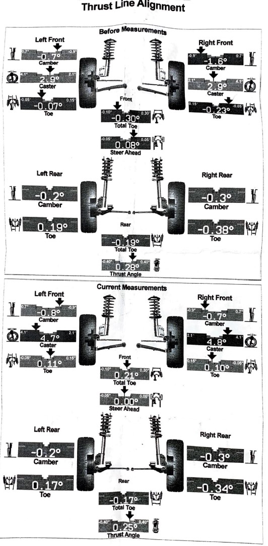

Hey everyone. I bought a 2016 Yukon XL about a year ago. I always wanted a larger SUV for my family. The extra cargo room and V8 pulled me in. Luckily, I bought a warranty because I've replaced the A/C condenser and steering rack so far. I'll post pics of my mods. From center hub to bottom of each fender, I'm sitting at 26" level on all four corners. Best guess is a 6" lift over stock. I've been able to find a lot of helpful information this past year on the site, but I never introduced myself.

I just added a larger spacer between the bottom of the strut and LCA. I think I reached the limit for a safe ball joint angle on the UCA (pics in original post). Thoughts?

Looking at it now, the track width on the front is much more narrow after the spacer addition. I may need a wheel spacer or knuckles.
