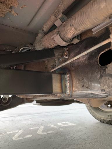

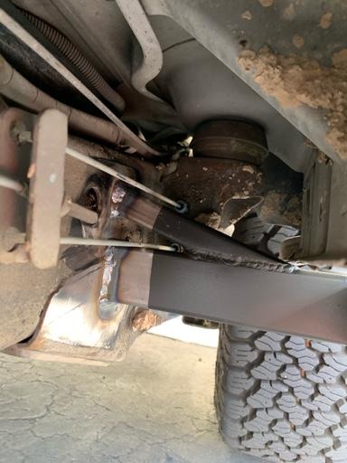

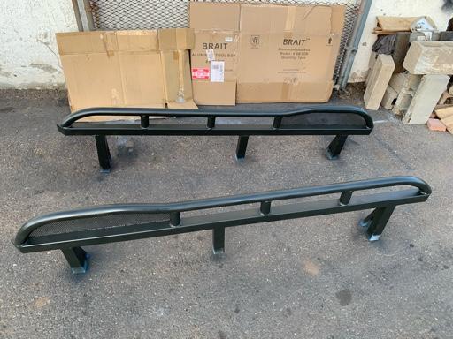

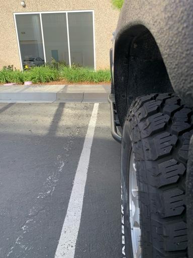

These are my sliders/steps on my Tahoe. Hopefully this helps you figure things out.
Front driver
Rear driver

@LTG515 Those things look tough! Did you make them yourself or had them made? Either way, they look awesome!
I had a guy make just the sliders because I found him on OfferUp and liked his design. My brother in law and I then figured out the mounting legs on our own.
