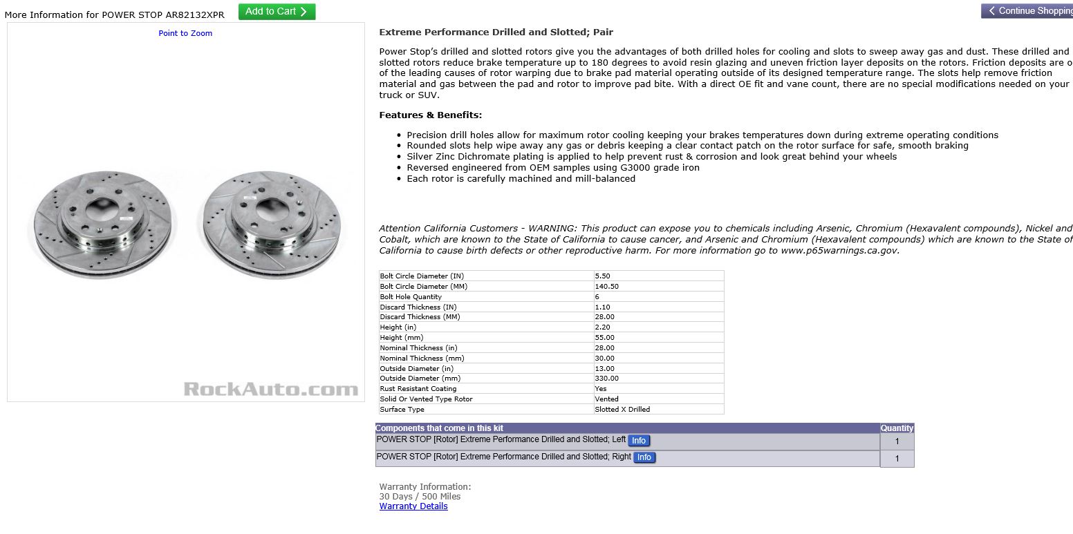

i like the lifetime warranty-might just buy the rotors and research the brake pads. a ceramic only pad is the better option with the slotted and drilled rotor?
I have the powerstop z23 rotors and pads, and I tow a lot. They’re excellent and in my opinion the z36 aren’t worth the added cost.
Had a panic stop a couple of years ago on I-95 when a car careened from the far right lane to the left lane where I was after he was rear-ended by a truck. To this day I don’t know how I missed hitting that guy but I credit the z23 brakes with helping my wife, daughter, and me avoid disaster.
