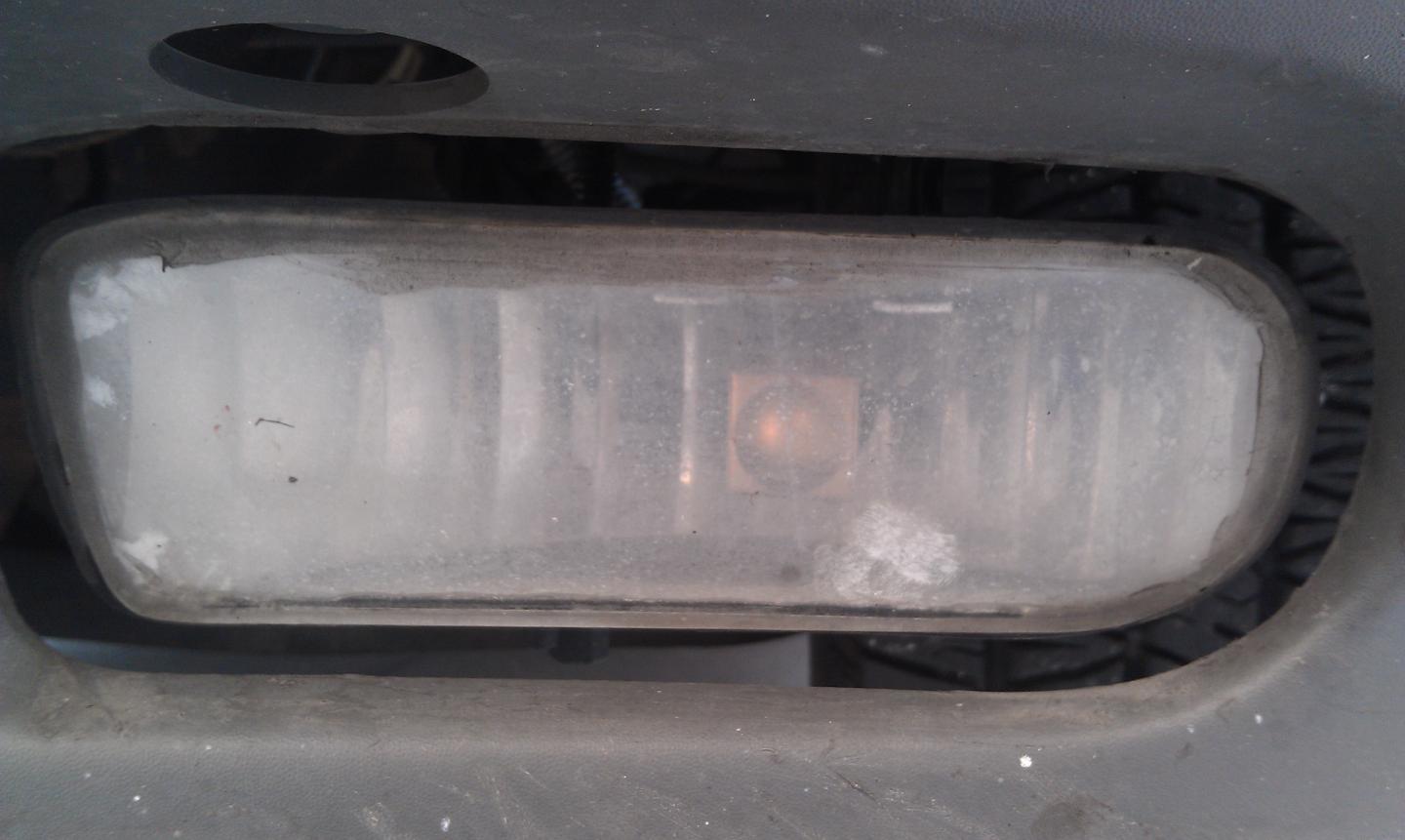

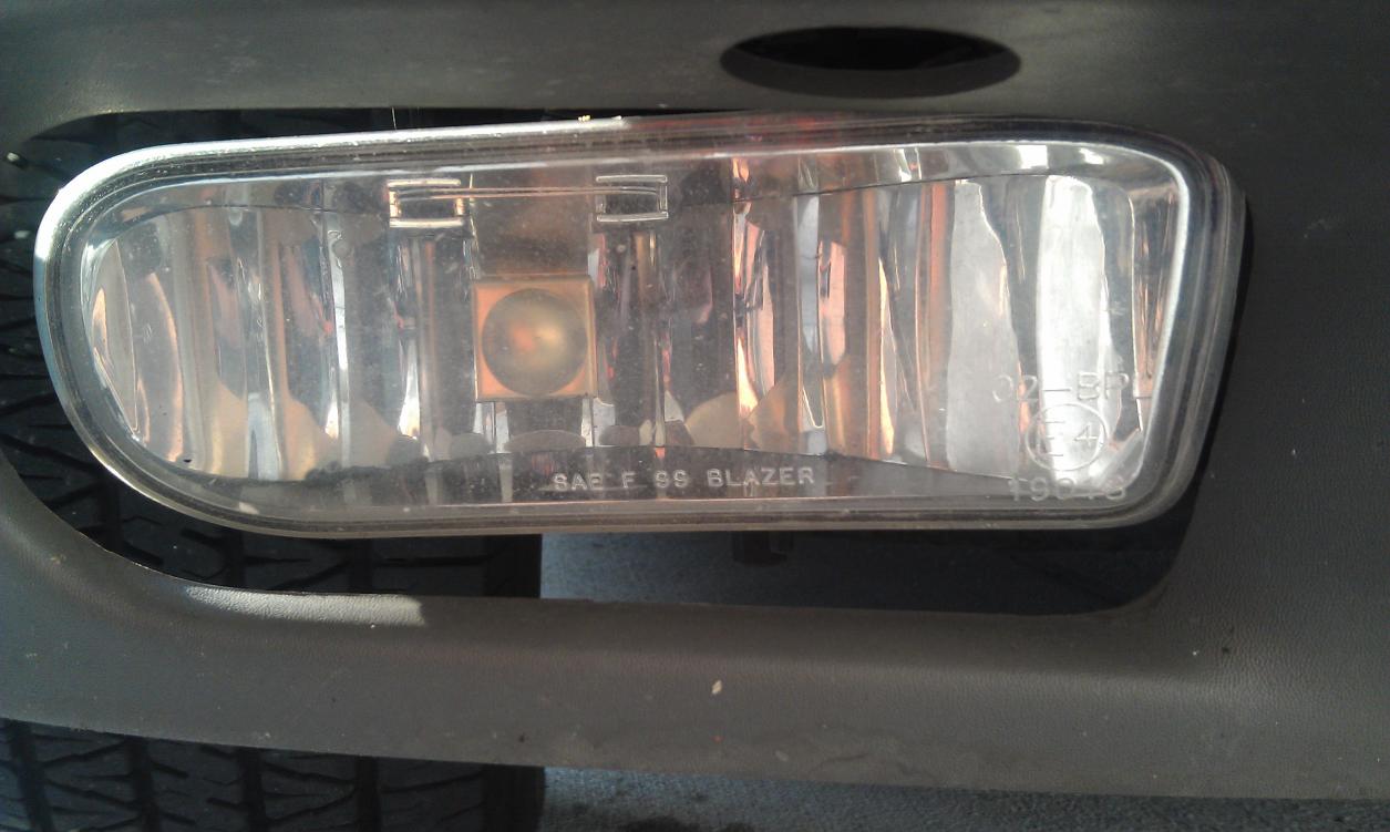

Here are the pics
I may or should replace the right-side housing. Like I said I lost the OEM lens so I found replacements on e-bay & they turned out to be plexi-glass machined to fit the OEM housing. This experience has taught me that plexi-glass isn't really meant for any type of lighting.

yea that lens dont look to good i would look into this p-1 fog jae is talking about or just replace the hazey one and buy better bulbs either way its your call id hate to tell you to spend your money one way and you not be satisfied
