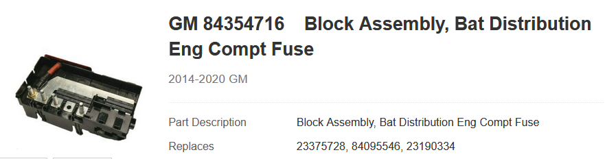

Does your positive battery cable connector have the separate studs on it, with wires going off to various places? If so, each of those is a fused stud. Test for voltage at each stud.
