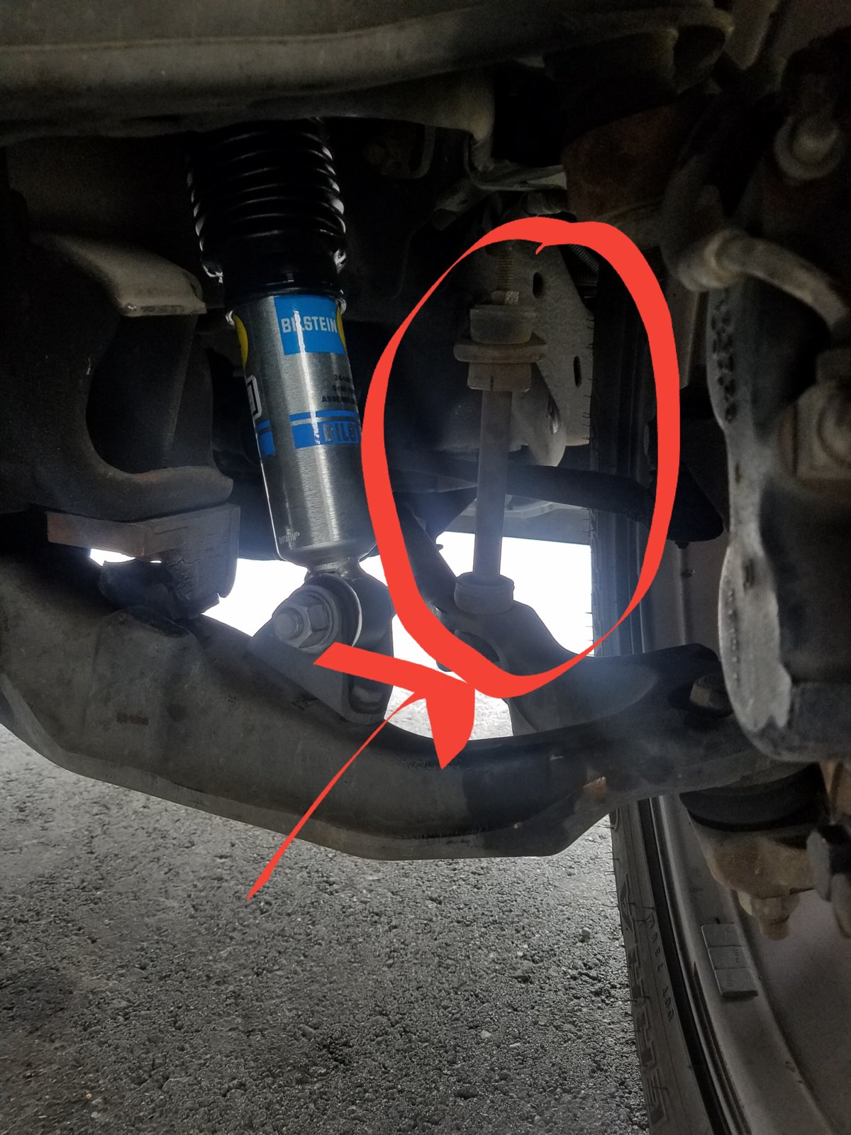

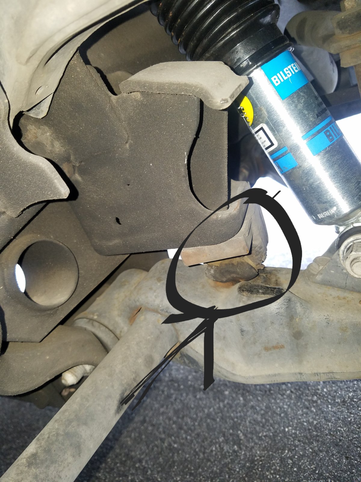

Can anyone tell me what this part is called?
I've been going under the truck and replacing whatever looks the worst under there, to eventually replace everything. But with my limited knowledge I'm taking it slow.
The thing I've circled looks like shit, looks the same on both sides. Pictured is the passenger side.

Order the Z71 bump stops instead of the stock replacement, GM PN 15835667.

Yes those are for 3/4 ton. That is what I have as well. They are from the Z71 2500HD trucks. You will probably notice the front is a little higher after installing these because the 2500 trucks ride on the bump stops and they aren't smashed like your stock ones.

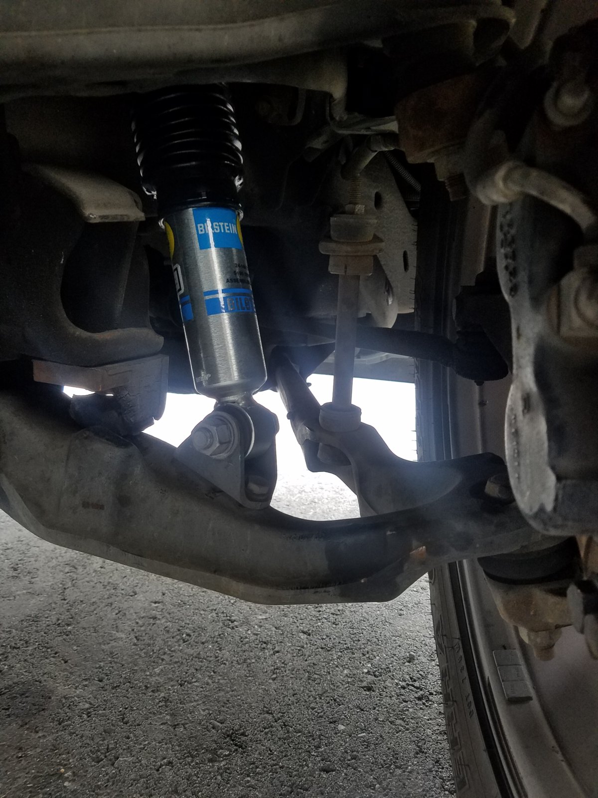

Thanks for that information. I ordered 2 and now I'm waiting for them. Can you also tell me what the thing is in the below picture? Is it supposed to look like that? I looks naked to me for some reason
View attachment 200159 View attachment 200160
Sway bar end links like was said. They're supposed to look like that but if the rubber parts are damaged they should be replaced. They're not naked lol.

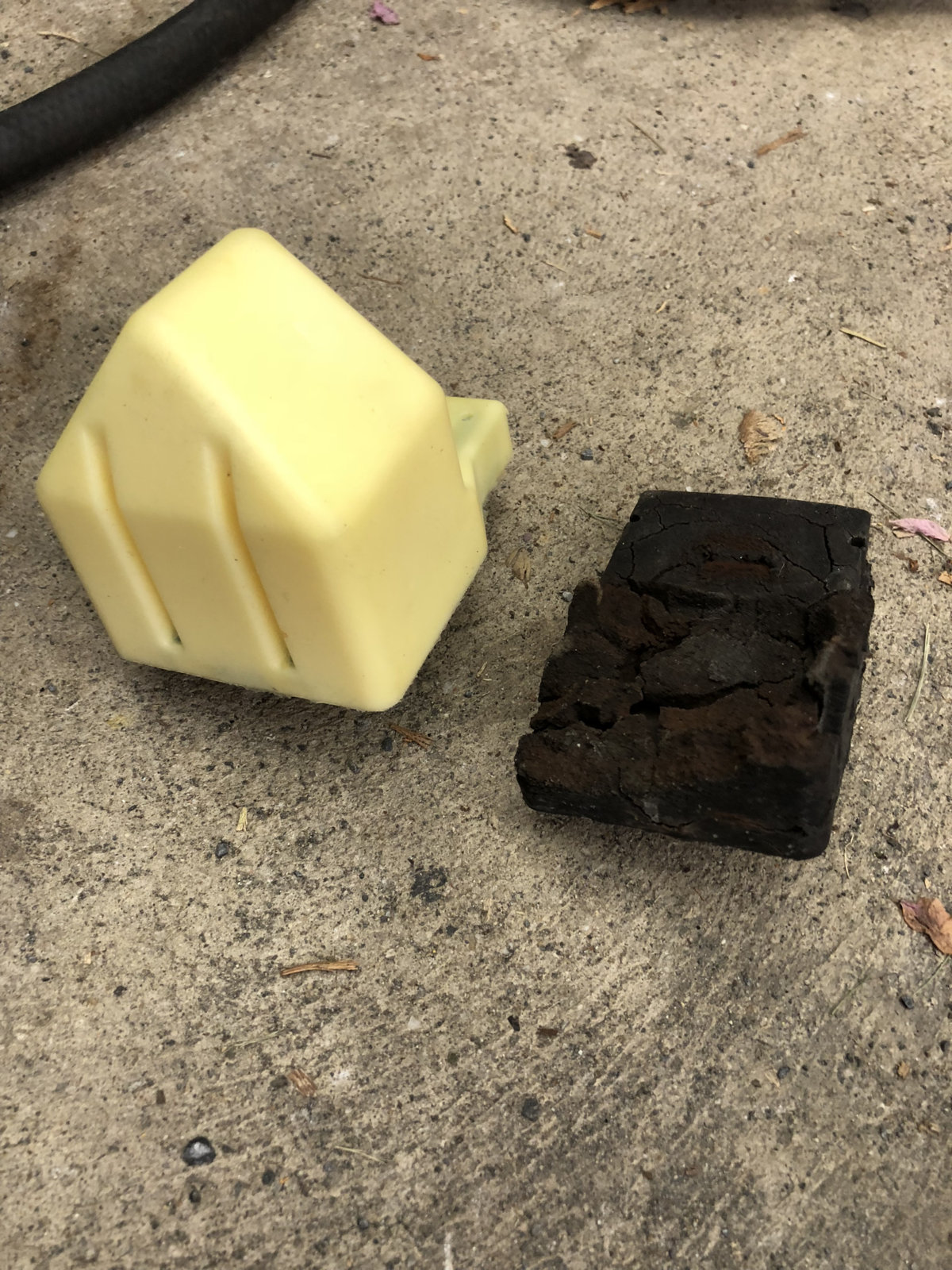

This is what my bump stops looked like after 155k miles. I think I could have gone a few more miles...
Pictured with the Z71 parts I mentioned earlier. The stock replacement parts are rounded at the top instead of pointy. Rides great now, just have to replace a bunch of steering parts now. Noticed the pitman arm is wiped out. Going to replace the tie rods, idler and bracket, and ball joints. while I'm at it.
Dude that thing is toasted!! I ordered the z71 bumps from gmpartsdirect when you first suggested them and still waiting on them! UPS says Friday so I'll get them in this weekend and hopefully get some pics uploaded
