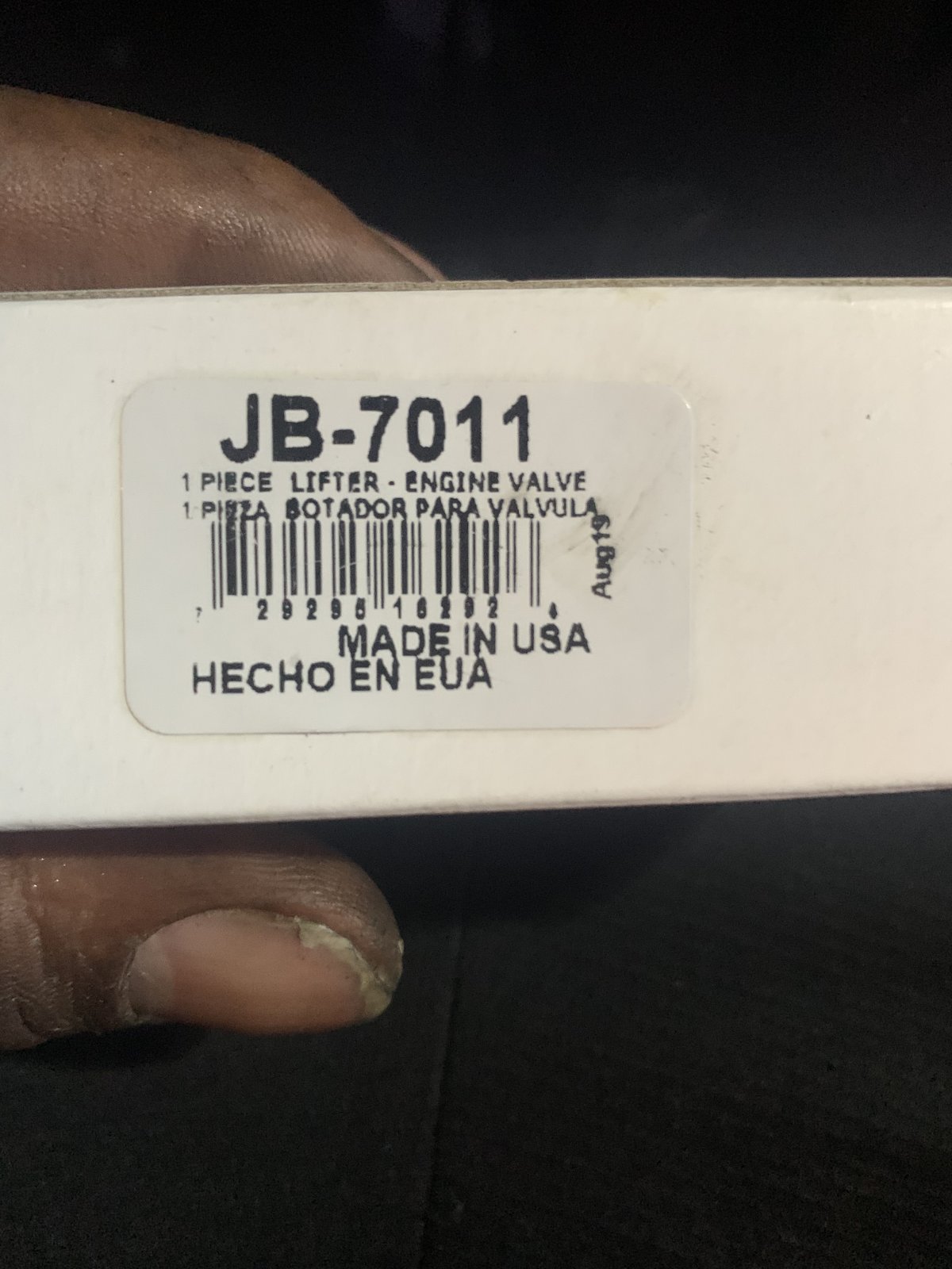

I replaced it with this one it was for cylinder 4 afm lifters and cylinders

This is what I got for cylinder 4
That is the right lifter from Melling.
A P0300 is a random/multiple misfire. What that means is more than one cylinder is misfiring, it doesn't necessarily mean they are random in nature.
The scan tool that you are using to see the codes likely will let you see the misfire counts for the various cylinders. Knowing which cylinders are misfiring and if it is say 4 and 6 misfiring (say the two you disturbed the wiring, injectors and coils on) or cylinders from both banks would be really helpful.
