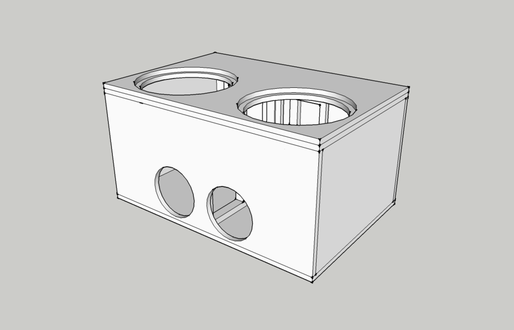

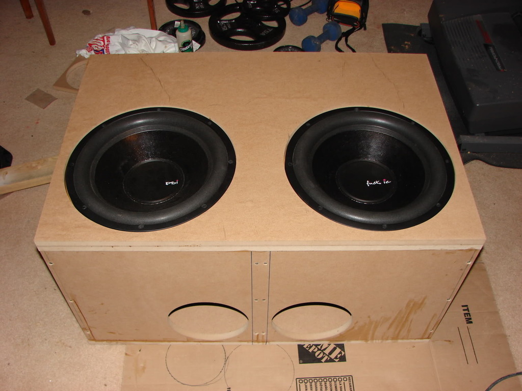

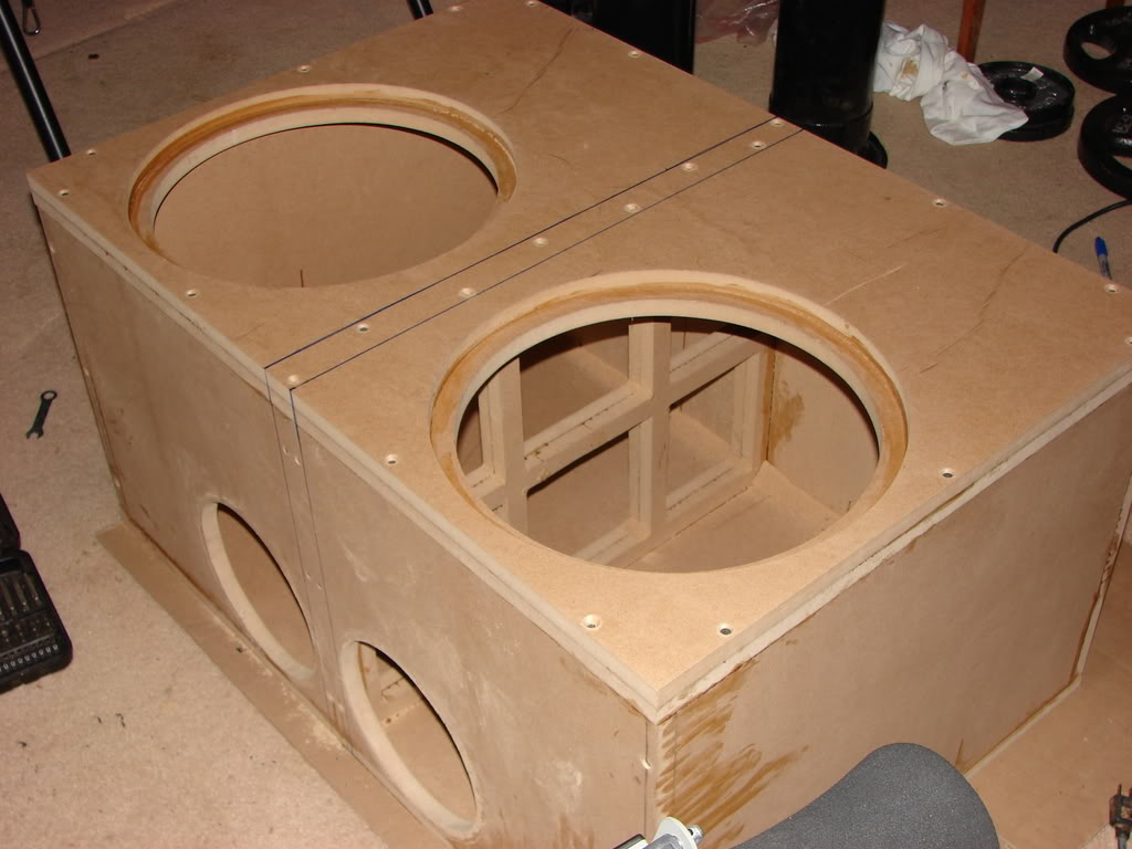

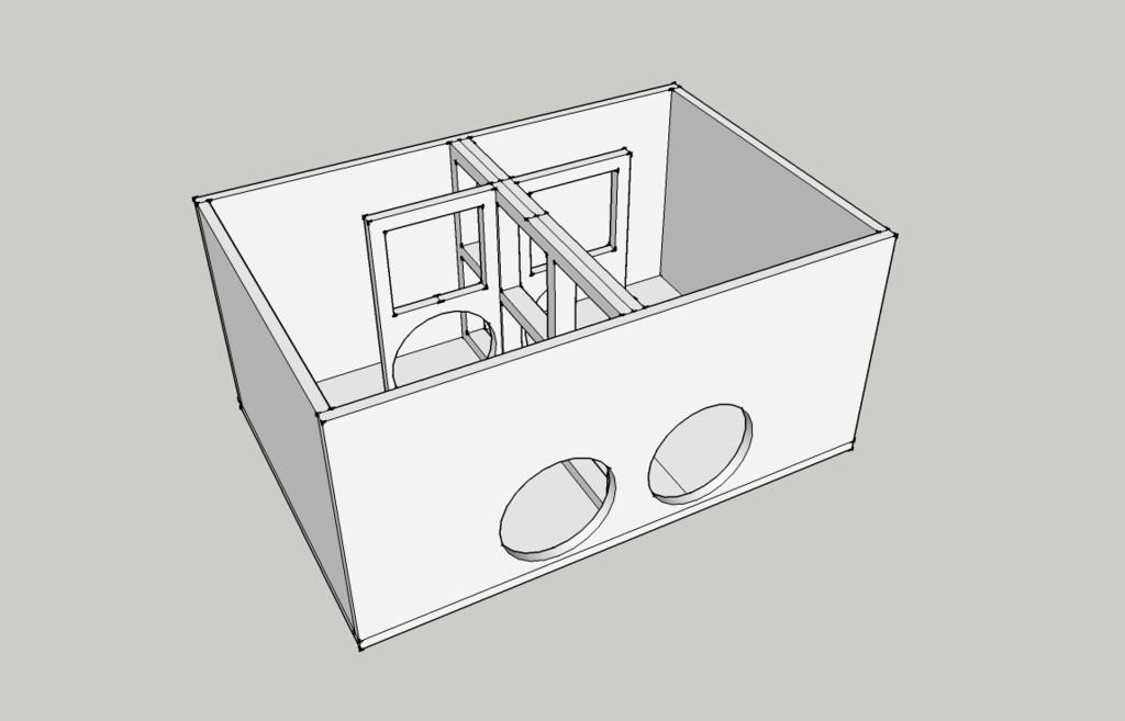

I love aeroported boxes. I did this box in Jan for my friend's custom RE HC 15s.
You'll have to factor in port and woofer displacement so that 8-9 cube ported box will actually end up being closer to 10-11 cubes.
You could go with a pair of 18s sealed(48x21x20) for daily pounding/lows/sq, and do a full ported box for spl/comps(12-16cubes) down the road or whenever you wanted to. Boxes are cheap, new woofers are not lol.
