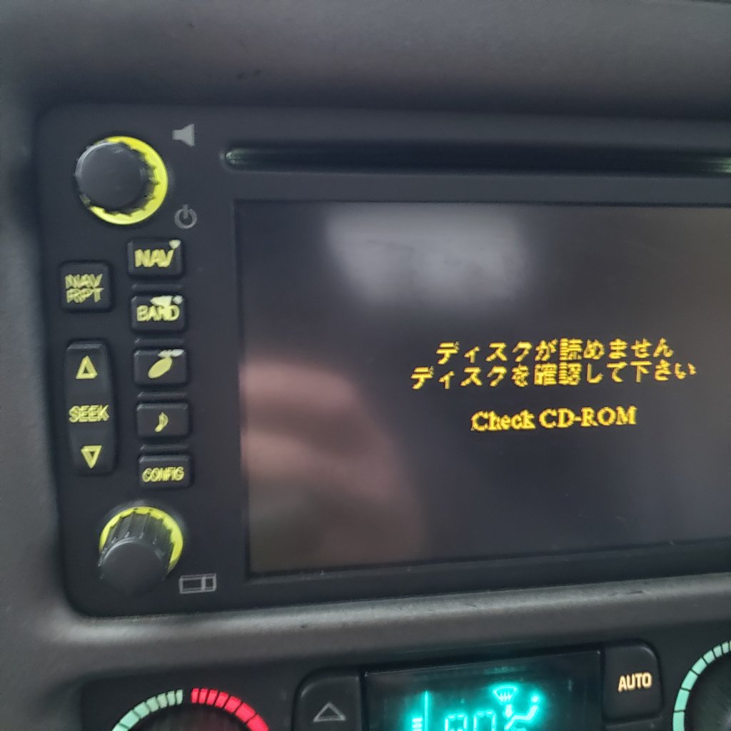

Hey amigos,
Here is the screen of my 2005 yukon xl Denali navigation radio.
I bought it from a hot weather state, Texas, and brought it up to the freezing polar vortex of Michigan. I wonder if the freeze cause a shortage and now it malfunctions.
The weird part is, the radio works?!?!? The radio knob and volume knob work, as well as the station button and volume button on the steering wheel.
The source button does not work, meaning I can't change it to CD or DVD.
Even weirder is, the rear entertainment system works, unfortunately I cant hear the movies on the SUV speakers but I can using headphones.
So... any ideas??? I checked CD-Rom. No CD in it lol
I opened the DVD nav unit and found no signs of burnt soldering?
