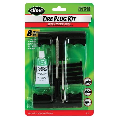

I used that same kit to repair my tire last fall.....still holding air just fine;)

Don't plug it patch it becuase most tire shops won't tuch a tire after its been plugged
Sheriff
Apr 18, 2011
494
Don't plug it, patch it. Because most tire shops won't tuch a tire after its been plugged.
I've never heard of such a thing. Who told you this? And what was their logic or reasoning behind it?
I have used plugs forever. And they work well if done properly.

LMAO that is the EXACT kit I bought from Wal Mart
Oh and because the nail was so close to the sidewall (about 2 inches) no corporate run tire shop would fix it. I already have a new tire on order anyways, it was only $200 shipped.

Don't use that green slime stuff. Makes a HUGE mess when dismounting the tire and most shops will charge a lot since it's a pain in the ass.

This discussion makes me feel like I am in the Twilight Zone.
How in the Wide World of Radial Tires does it make a mess?
How could a simple plug affect dismounting of the tire?

Exactly... I use the plugs but yea I see where he says the slime **** goes all over the place and its an ass to clean up...

I guess I see the confusion now. The green package I posted is
brand name "Slime". It's not actually any type of green slime.
It's simply a tire plug kit.
