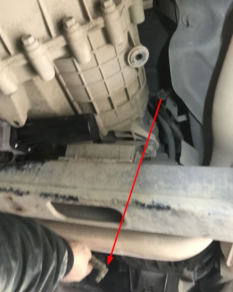

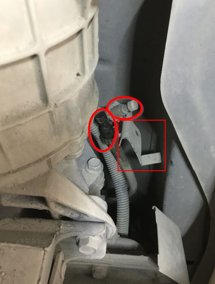

I just replaced the 4WD encoder motor assembly on my 03 Tahoe ZR71 5.3 FFV - haven't tested it yet, but I found 2 hoses that route up over the transfer case/transmission. They could be vacuum lines, but I can't figure out where the other ends are, or where one of them should connect. Both appear to be plugged at the tail end, and one looks like it's leaking:

The one you say is leaking is likely just wet and oily. You can remove the vents and clean and reinstall.

By the way, when you reinstall the lines after cleaning the vents, make sure to have them back in their "up high" connections. They need to be higher than the component they are venting.
