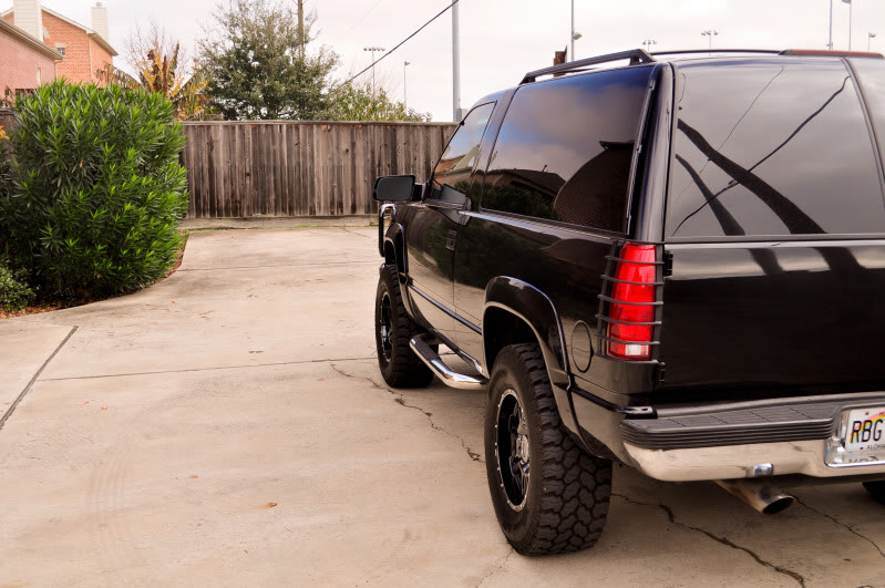

It’s taken about 2 years of on and off again work and a *** of cash, but I finally got her about where I want her. I owe many thanks to the folks on here for recommendations and their knowledge. Sunlit deserves a lifetime supply of beer.
Here’s a little time line with some pics. Some of the pics are of how tweaked a few of the components where that I replaced. Others are some shots with and without the new stuff overtime. Most everything on the last project was underneath the skin. I need to get her buffed and waxed and do another photo shoot.
Gone through a couple trannys and had to replace the rear diff in the late 90’s
2010/11
Started with new paint (not too pleased with the paint job)
-Complete redo of the interior. Carpet, seats, and headliner.
-Replace front brush guard
-Replace Nerf Bars.
-Powder coated tail light guards. Rhino discontinued that style and I could not find new/ used ones. They’re the only ones I liked. But the powder coat brought them back to new condition.
-Redone Flow Master exhaust. Series 40.
-New rims. ProComp Knight Chrome. Procomp tires.
