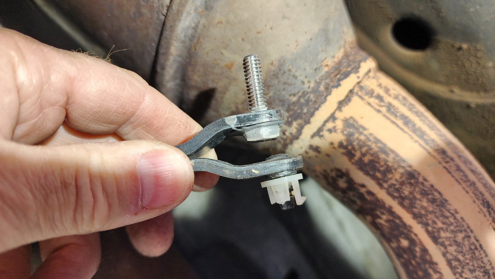

Found the Fitzall post, ordered their bushing. Installed it and noticed that it snapped into place on the shift lever groove, but it had a bit too much sideways movement for my liking. I then realized that one of the prongs on the clip had snapped off on installation, so back to researching.

Here's what I came up with - 1/4" Nylon Flanged Bushing - x2.
Another view with just one in the shift cable eye.
Surprisingly, it fit like the proverbial glove.
Next, I wanted to eliminate the chance of being stranded if/when the bushing broke down the road, so I captured the bushings with M8 fender washers.
This is what it looked like at the hardware store -
The "ears" sticking out of the washer will be trimmed flush.
Next was finding a suitable bolt that fit snugly inside the flanged bushings - 1/4 x 20 bolt worked just fine.
So, back at the workshop I removed the spare shift lever from the LS swap transmission - the swap is still in progress, so it wasn't being used - and removed the shift lever nub and drilled to fit the 1/4x20 bolt.
I didn't have access to a welder, so I used Original JB Weld on the bolt head and threads going through the shift lever.
Once cured and test fitted, it looked good.

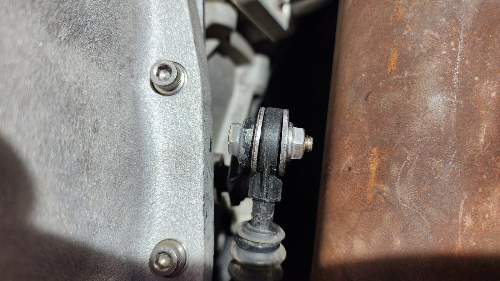

Next was to swap the shift levers and install the bushings and washers. This is what the Fitzall bushing looked like, next to the updated captive bushing.
After swapping shift levers, I used red LockTite on the threads.
I've installed a deep trans pan, so had to slightly adjust the lever to avoid contacting the pan. I thought the clearance to the driveshaft would be less, but there is plenty of room.
All in all, the cost was less than $7.00 and my time, but I'm confident that this won't leave me stranded like the other bushings. I bought two sets of bushings - the spare set is in a labeled ziplock in the glove box.
The shifter feels much more precise and less loose - after a couple of thousand miles of daily driving, everything is stable.
