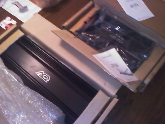

AUDIOQUE 3500D (WIRED TO .8OHMS AFTER IMP. RISE)
AUDIOQUE 4X90 FOR MY INTERIORS

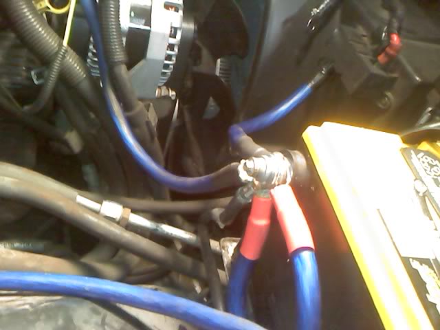

OVER 100FT OF O/1GA WIRE
190A DC POWER ALT

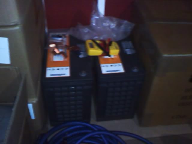

2 CD UPS BIG BATTS (100LBS EACH)

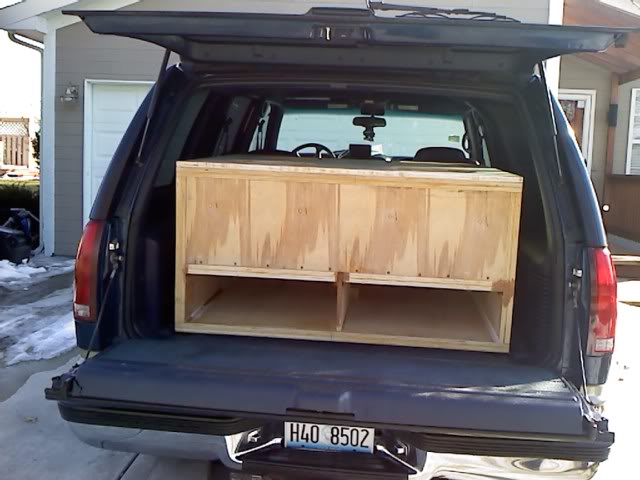

BIG DUMB ASS BOX! LOL PORTED TO 36HZ

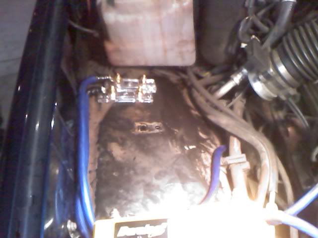

ALT INSTALLED

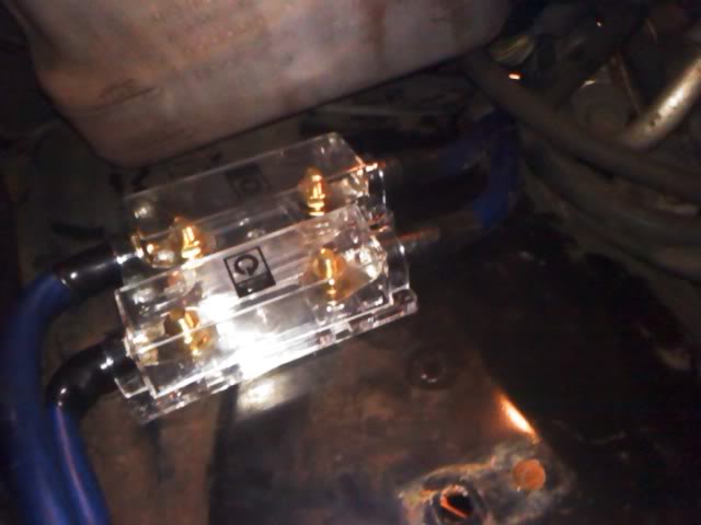

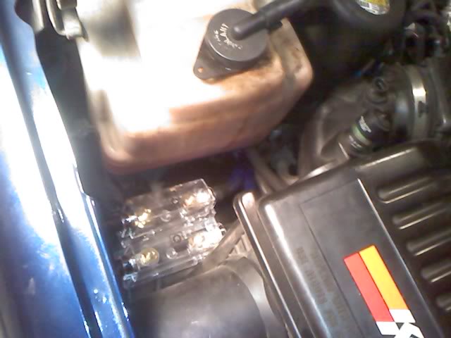

FUSE BLOCKS AFTER AIR CLEANER PUT BACK ON

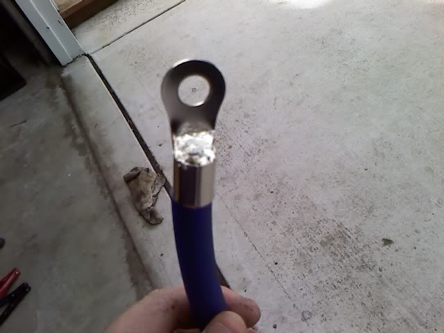

MY FIRST TIME SOLDERING RING TERMINALS! :)

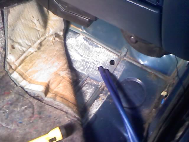

WIRES RUNNING IN

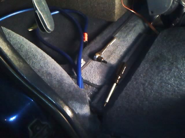

OUT BEHIND THE BACK SEATS (WILL BE CONCEALED WITH THE BOX PLUS TRIM PANELS
WHAT THE BOX LOOKS LIKE IN THE TRUCK
IM HAVING MY HOMIE THAT WORKS AT SHOCKWAVE CUSTOMS DOWN THE STREET GOING TO MAKE ME FIBERGLASS TRIM PANELS AROUND THE BOX SO IT LOOKS MORE CUSTOM AND IM HAVING HIM DO SOME STUFF WITH THE TAIL GATE PANEL SO I CAN PUT SOMETHIN CRAZY ON THAT ALSO

Shouldn't there be rubber grommets here where the cable passes thru the steel floor??
i caulked it all up after that picture lol and both wires are fused both up front from the battery under the hood and in the back b4 they reach the 2 batts back there so if something "is" to happen they will just blow the fuses :) like i said im way overkill

How do you setup remote batteries like that?? Just connect them to the main battery or run a separate alternator lead?? Any diagrams?? I've seen a bunch like that here and I'm kinda curious.
riviera rider
riviera rider
Oct 6, 2009
410
nope just run the power wire off the front battery and fuse it in the front and in the back b4 the battery, im running dual 0/1 ga to the rear batts then dual to the amp and dual grounds off the amp :) got some blocks cnc machined ill post pics of those when i get home later

i would have drilled through the fire wall. does the carpet have a
bulge in it wire the wire is coming up?

a little but you cant really tell with the floor mat there
and give me some looseness lol i havent done a real install like this in like 4 years! im a little squeeky but its all coming back to me lol
