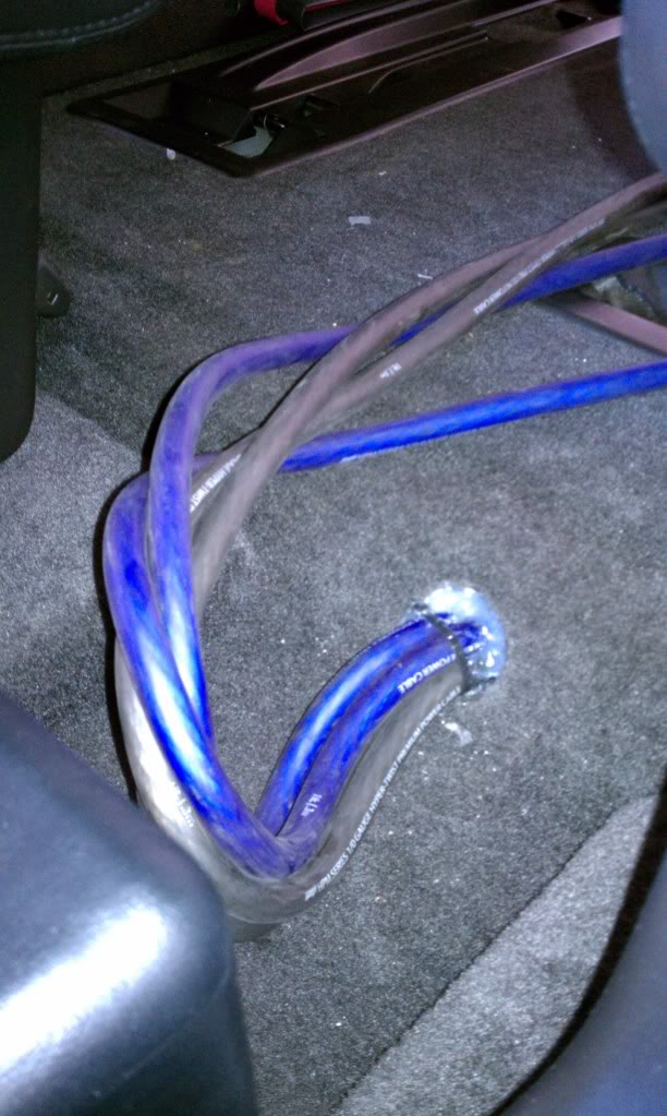

Its my daily driver, but I also compete with it and since I'm running a lot of current, I wanted to do two positives and negatives from front to back to minimize voltage drop.
I ended up going under the truck down the driver side and over the gas tank. I brought the wires in right before the last hump that starts the cargo area because that's where my batteries are gonna sit. I'll post pics when I close out the truck tomorrow.

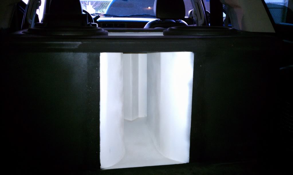

Well I can't post complete build pics due to the fact that my amp smoked as soon as I turned it on :wtf2:(By the way, where did all the Homo smiley characters come from? I couldn't even find the normal ones lol)
Anyways, here are some pics that I have.
And My Battery Box
Also moved my 360. It was kinda messy since I was in the middle of an amp install.
