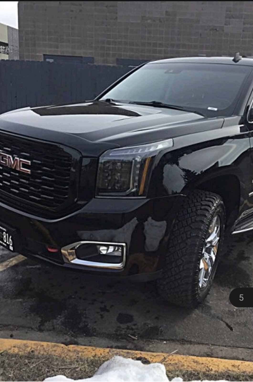

Finally got around to taking care of wheel rub on the Yukon. This made for zero rub with 295/60/20 Atturo X/T which are 34.2" diameter.
Section width is 11.5"
Suspension Maxx lift 2.75" front 3.5" rear
First video using the gopro but basic technique once you have the wheel off and carpet pulled back a bit:

Heck yeah - sorry about the lack of video-skills but at least you can see where I cut. Way too easy.
Took through the local river bottom up/down steep grades with some reverse driving over bumps and no issues.
Other tires at stock offset with RC UCA's:
33x12.5/20 Trailblade M/T inner sidewall contact UCA at nearly full lock; 32.8" diameter (12.5 section width)
295/55/20 Trailblade MTS inner sidewall contact at full lock; 33" diameter (12.2" section width)
Will be making another 2400mi round trip with 1000lbs on the hitch hauling the camper next month. In the next couple weeks I'll know whether that changes anything. There's still room to tap the fender well back further if needed.
