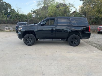

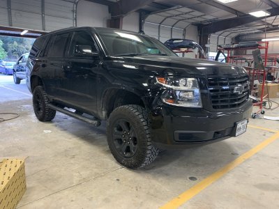

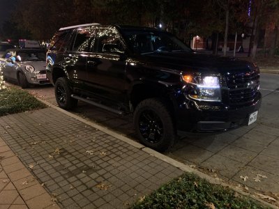

I have a 3.5” leveling kit with 2” in the rear and it rides great. I have a midnight edition LS and the wheels look great.
REF0603
Jun 10, 2014
35
48
Montgomery, TX
Here are some photos. Now I just need new wheels and tires. I might just get some spacers, but bigger tires for sure
