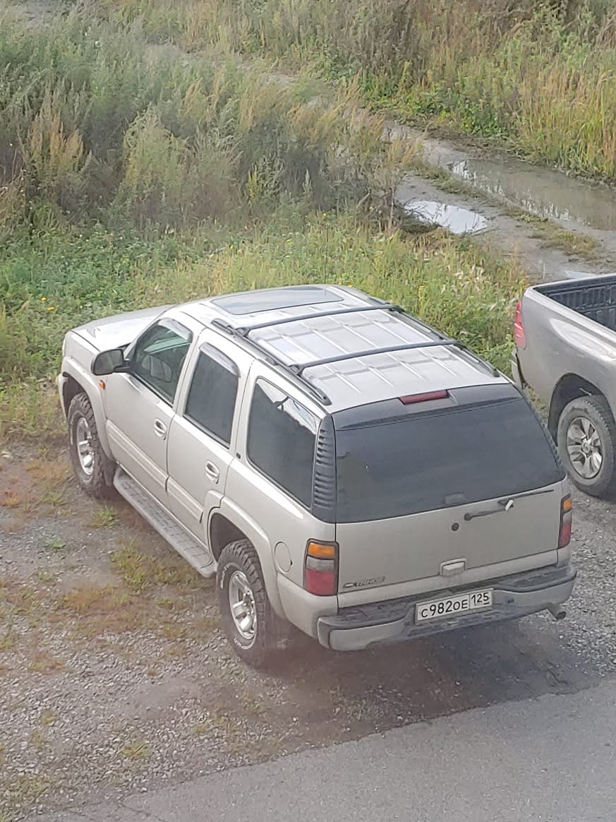

My 2006 LT Tahoe has 33 inch Goodrich BF MT
But I changed torsion keys at the front and installed Z71 coils at the rear before (I suggest this was not necessary to fit these tires). Even 33" wheels do not looks big enough for this car.
As for 35" - I think body lift must be done first.
