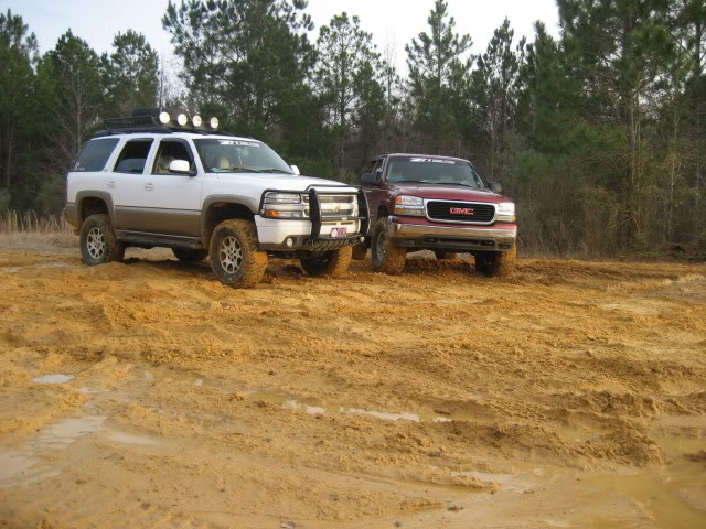

For shocks you want to go with the Bistein 5100s. They are great for the price and look good to. Offroad warehouse has them. Give them a call and tell them how much sus. lift you got. Tire wise, I have the toyos and my rears are gone after 1 year less then 20,000 on them. Im goin with the pro comps too. Cant beat the warrenty. You wont need wheel spacers to fit the tires but you will need to flip the top shock bolt so the tire doesnt rub on it.
Heres what your truck should look like
White Z71
2" keys and spacers
3" body
35s
