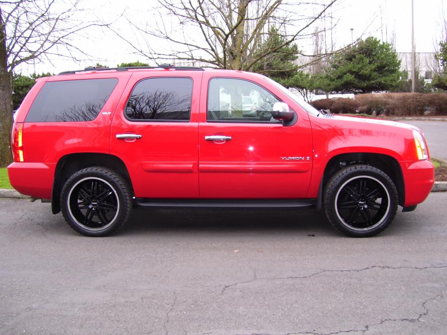

Does anyone know if I can get the amber marker cover out of my headlights on a 08 yukon. Do they sell them without? I have seen a few on rigs but don't know how they did it or if it a different light assembly you buy.
Thanks

There are a few members with NNBS Tahoe's that have done it here. It basically requires baking your headlights in the oven to soften the seal on them and opening them up to take the reflector out and then resealing them. Most members do it to also paint the chrome inside as well. I know Texas Demon and DwDrummer on these forums have both done it.

first off welcome to the site. you are going to love it here. as for the headlights, well you have two options you can either bake them in the oven, which takes longer and more of as risk to melt a tab here and there. but the best way to go about it is to use a dremel to cut the between the epoxy and the housing. once done doing youre mods all yo uhave to do is get some black epoxy re seal the entire housing and use clamps or bungy cord to prsure them togeather and leave them for a a day or to so to dry up. i used the oven method, but dwdrummeer i think used the drmel way which is easieer.send him a pm so he can give you exact directions.
