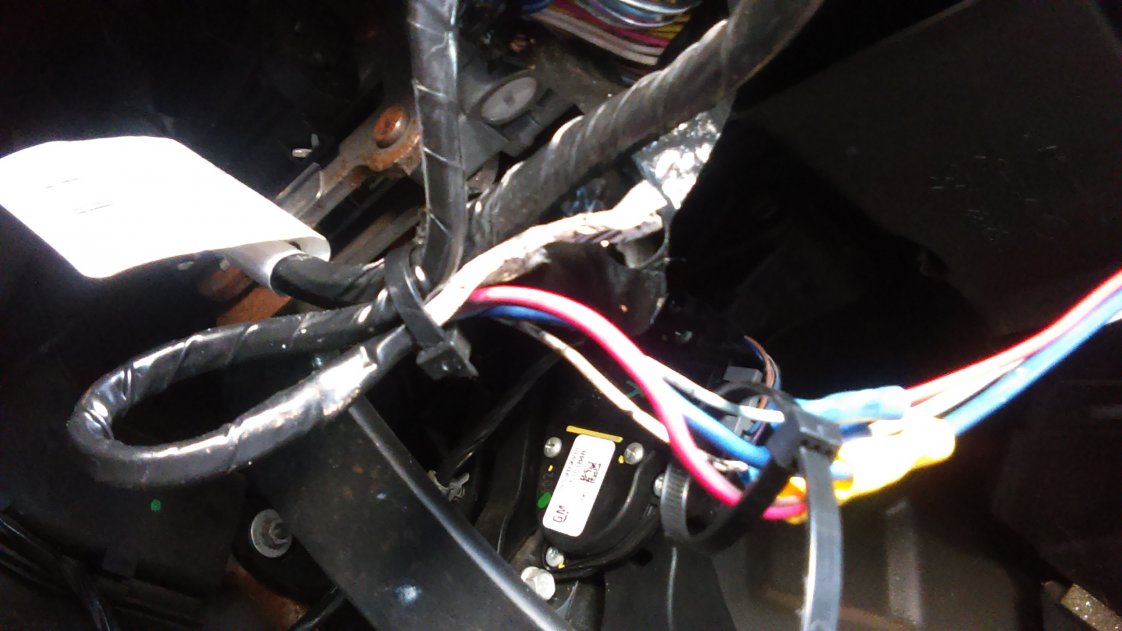

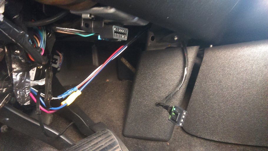

Hi everyone I'm new to this forum recently purchased a 2007 tahoe lt3 and I found this wire up in the dash could anyone identify this wire and the mount on my dash it didn't come with anything like a hand-held

That is certainly odd! Do those wires that are spliced together go into the wires that lead into your ODBII port or ?? :think: Looks like a mess under there.

Let's me get a pic and thanks 07burb
---------- Post added at 03:39 PM ---------- Previous post was at 03:33 PM ----------
Those wires are spliced into the harness goin into the engine bay

Powerhaulic, I was just searching up mounting hard ware and it looks like a prodigy brake controller thank you guys for the help
