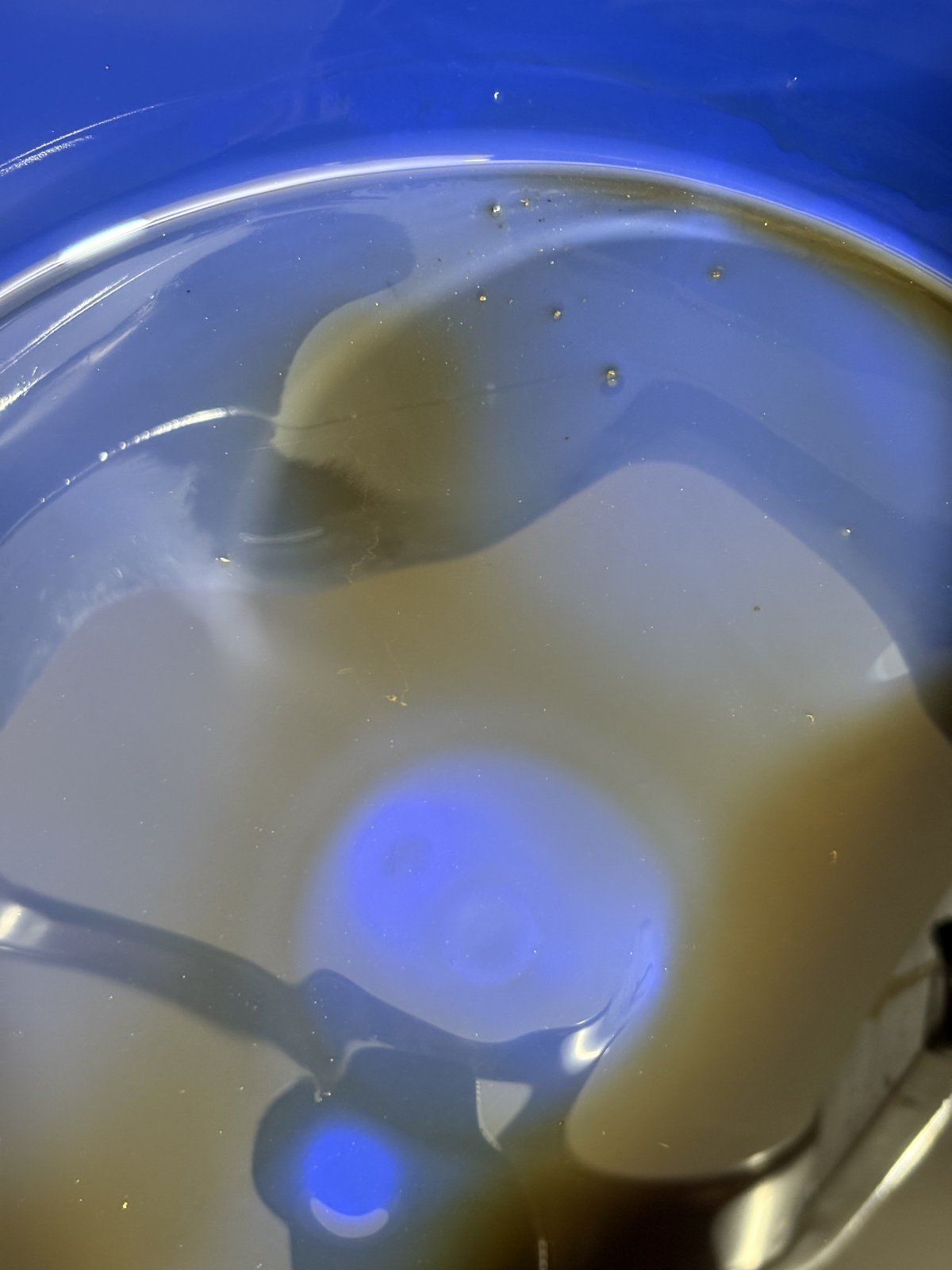

Digging deeper… left 1044.jpg is a 5.3 with 700 miles and the other one is an lz0 1k miles. Look at them. Up close. You will see the 5.3 has a lot of contamination in it. That is nov 2024 built yukon. I had an 2018 5.3 that was perfect. Old machining? Poor cleaning before assembly?
The diesel has newer tools building it. Clean first drain. I do not like 0w20 oil.. i change it at 3k.

What am I looking at in the attachments?
PPK_
Jan 15, 2024
160
150
Oklahoma City
Those are oil drains.. bucket emptied with syphon hose so you can see what is in the bottom of the bucket. Left side… you can see where the drain put a lot at the wall of the bucket.. and then as the pan emptied.. you can see all the debris right back to right under the drain. The 5.3 took three or four refills at 500 miles to clean up the drain oil.
The other side is 3.0 liter drain.. not bad. I would not get 5.3…
