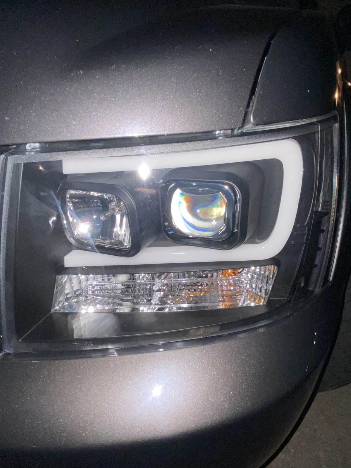

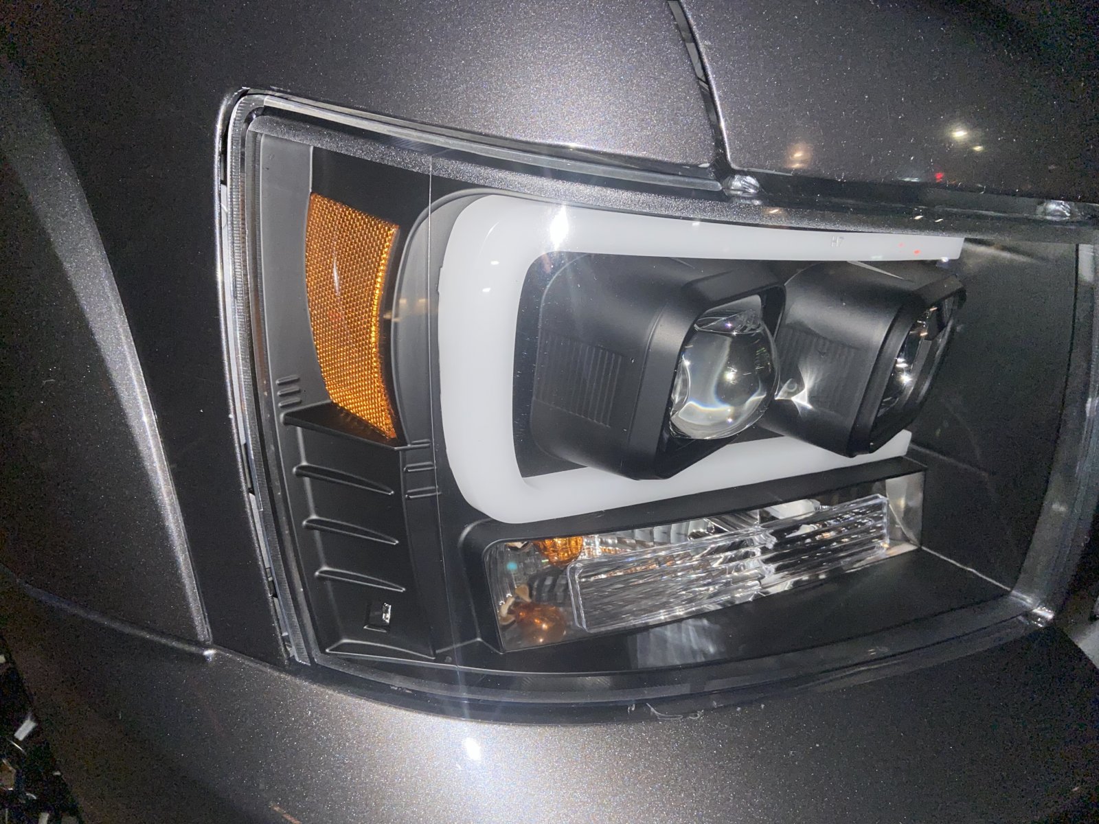

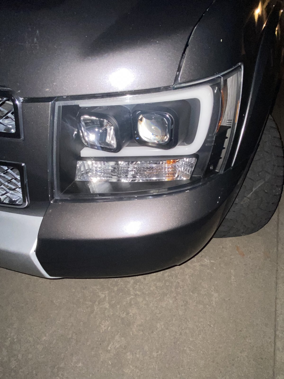

Sorry for crossing wires on information. Thought a photo would better explain.
“installed the MX series because the housing for the L3 was too big for your aftermarket headlamp assemblies and even still we had to modify the mounting to get these to fit.”
What would you do in this situation?
Thank you.

what I got out of that is that the lucas mx series is led? I looked at a couple such as the h13 which may or may not be applicable for your lights, those do not have any adjustment on them that I can see. led's a in projector housing probably will not work very well unless the projector was made for led, with the reflector the result is slightly better provided you can adjust them properly.
your lights look like they have projectors for the low beam and reflector for the high beam.
if you are satisfied with the high beam, but the low beam is funky I would go with HID's for the low beam instead of led

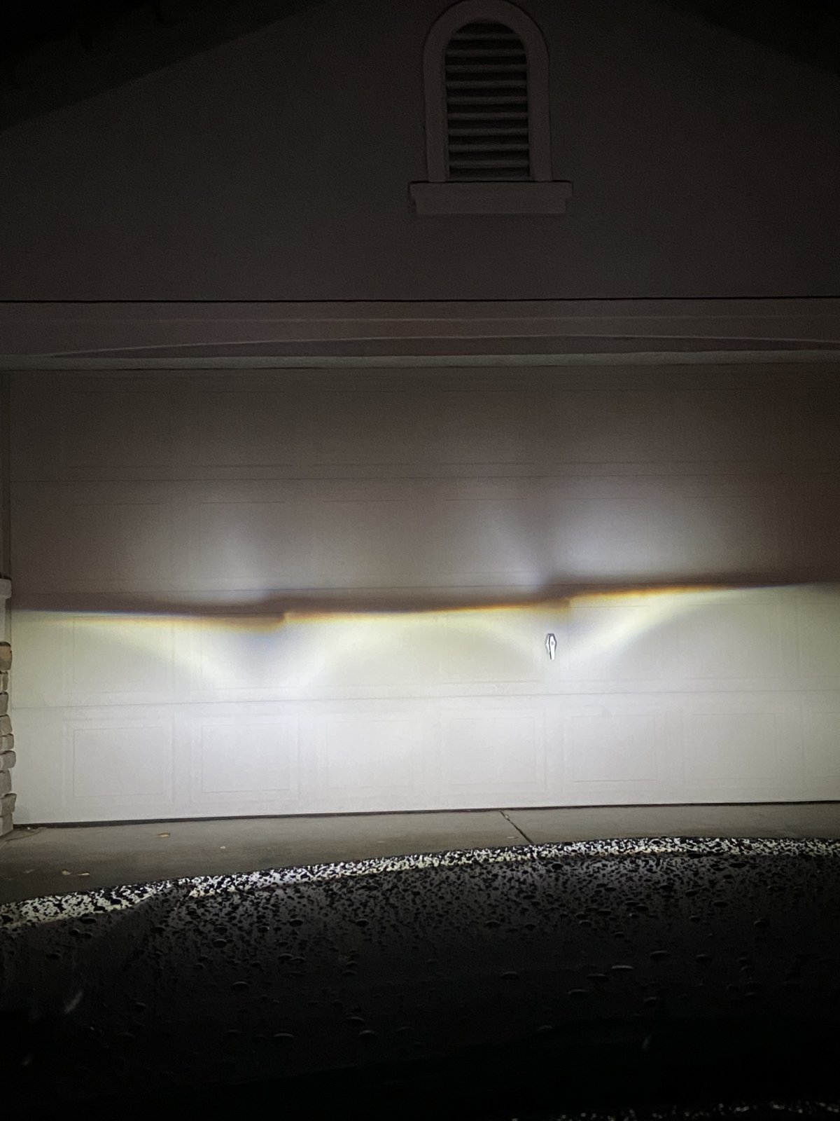

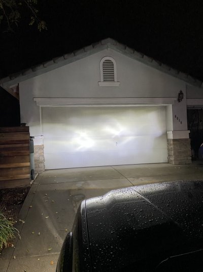

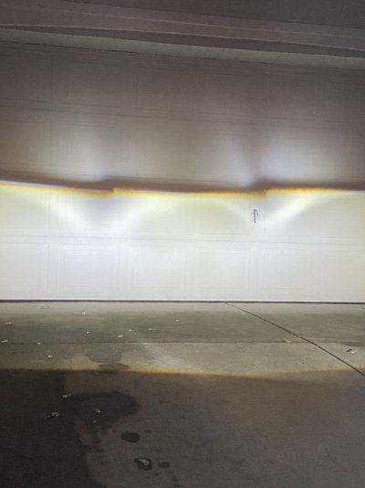

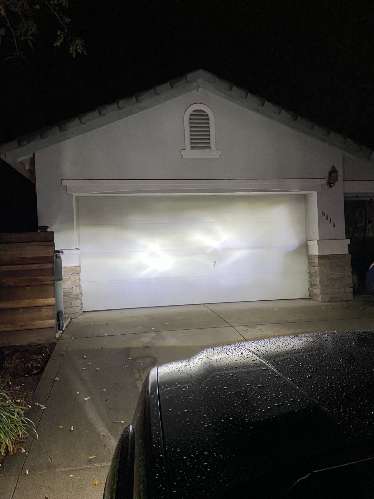

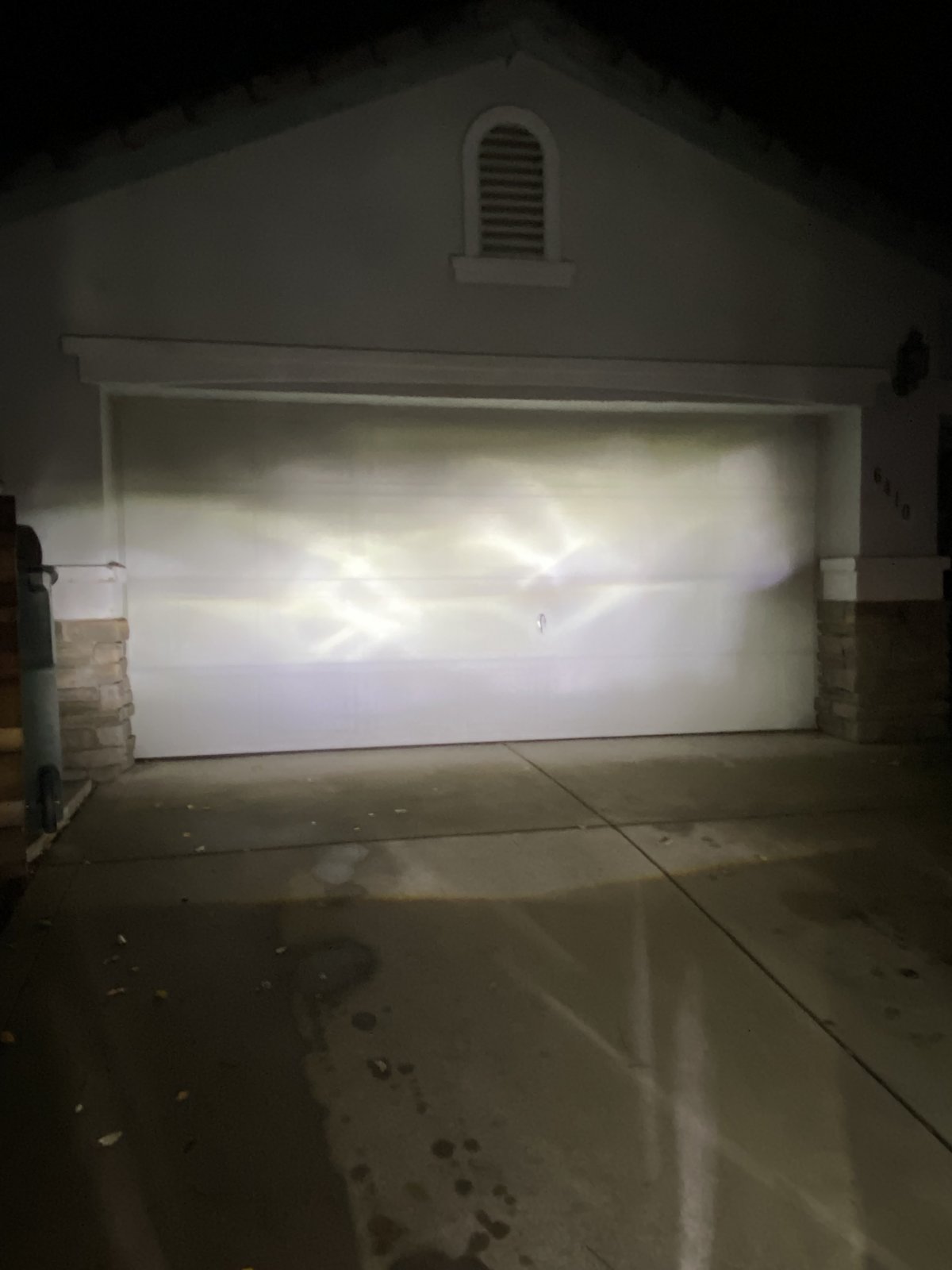

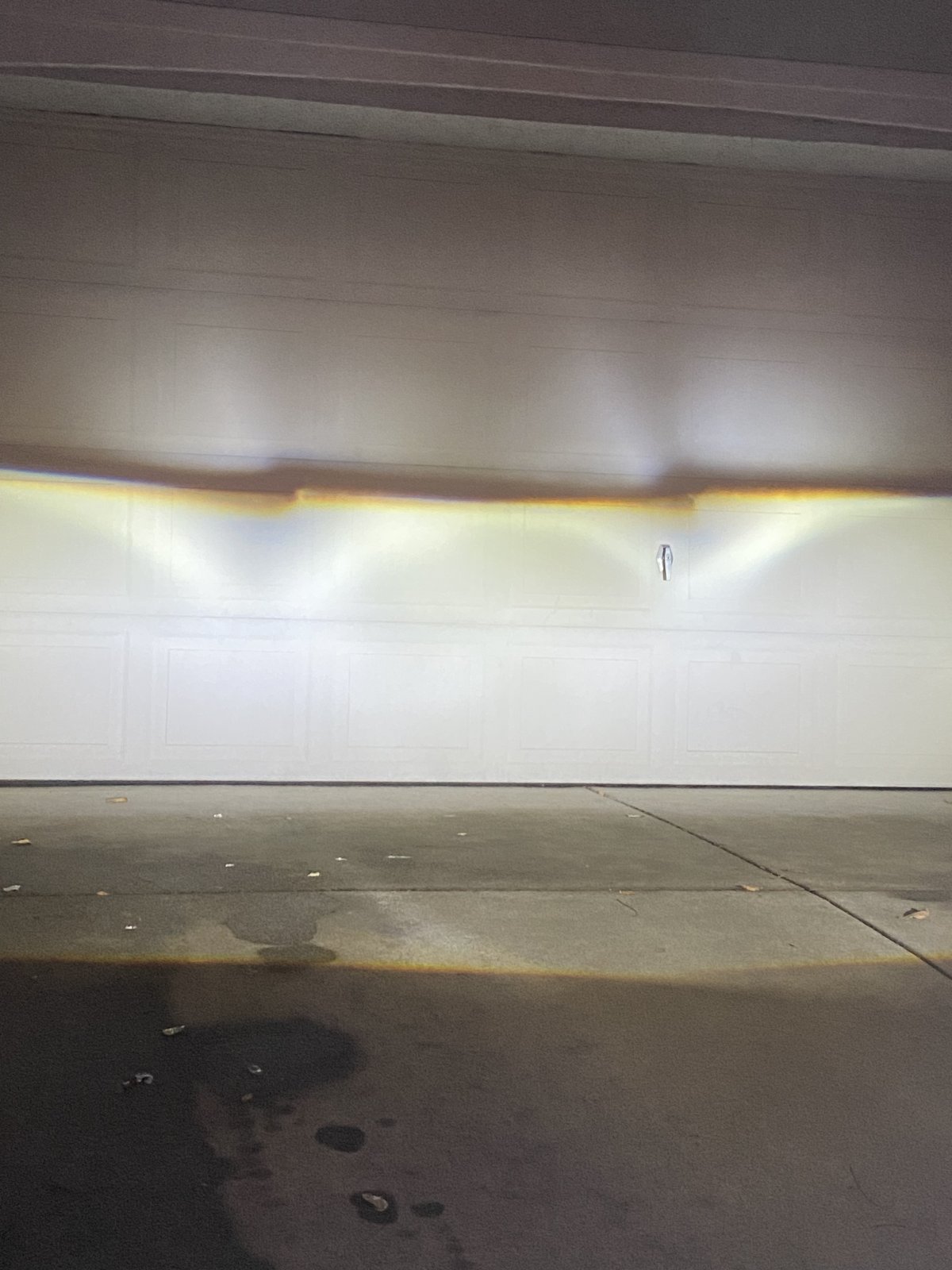

As requested . From different angles. From approximately 25 feet. High beam low beam. I like the high beams not at all disappointed with that. It’s the low beams I’m not impressed with. When a Tesla has better higher beams then you know you didn’t get what your paying for.
I looked up HID’s or the Xion gas lights that looks great. Would I need ballest for the HID’s? Any recommendations?
Thank you.
Ken

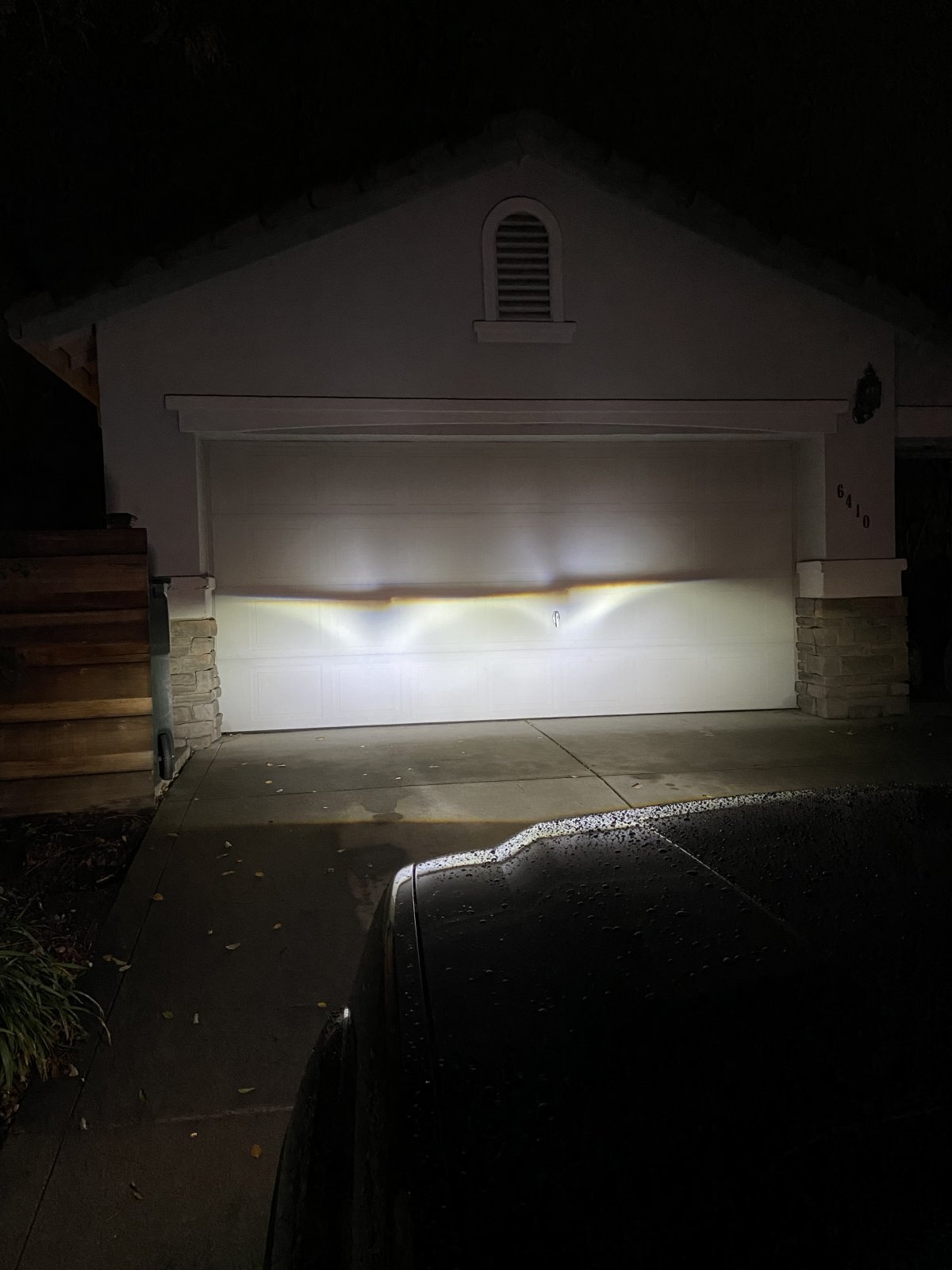

Not the best photo l’s but it gives you a perspective.
Ken

yes, I would order these, they have to ship from china so it takes around 3 weeks, these are very good quality ballast.
ballast: https://www.ebay.com/itm/113685340851
the HID bulbs are in general are all basically the same quality, there is no logical reason to overpay for some "brand name" I would just be sure to choose 6000k (color) that's the native color
I have these and they work fine, they should have the socket type you need. you just need to check which socket type your light housing uses for the projector side.
bulbs: https://www.ebay.com/itm/261924317257?var=560751536192
and it is probably a good idea to order 2 set's, so you have spare in case one happens to go out and you are not stuck with a light out because these are not sold in stores.
next it is a good idea to wire the HID's with a harness and a relay to the battery, hid's are power hungry they won't drain your battery or anything they just work best with full voltage. The stock vehicle light harness just is not the best choice when using hid, I would advise using a light harness, it is easy to hook up direct to the battery and a ground and then use the stock vehicle harness as a trigger for the relay. doing that gives the hid ballast a good connection directly to the battery
harness usually come somewhat universal but if you can tell me the bulb socket model then i can point you to a harness
