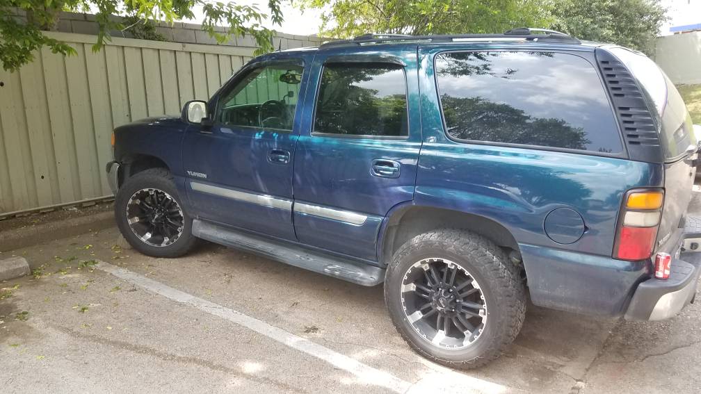

Here's 22's on an 03, that was just lowered. He had it stock height for awhile tho.
