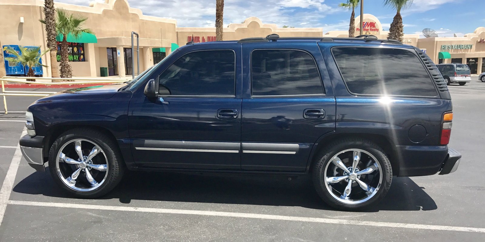

Did a 2/5 Belltech drip kit and 285-45-22 Pirelli tires and it drives like a car in turns.No clearance issues. Makes driving a bit more fun.
