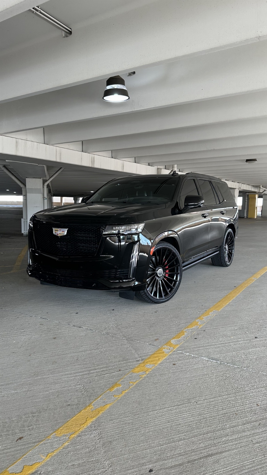

I'd love to see some more Escalades with wheel spacers.
My wheels are tucked in too far, but I cant decide if I need 1", 1.25", or 1.5"
Also, I want Bora since they are made in USA, but they also seem hard to find.
I plan to add the lowering links as well.

What offset are your wheels?

I honestly don't know, but they appear to sit in the wheel well the same as OEM wheel
There are tools for measuring how large of a spacer you'd need to create flush fitment with your fender lines. I'd call around to local alignment or performance shops in seeing if they have this and can help figure out what you need. Keep in mind however, if you go with a 1" hub centric spacer (1.5" might be ok), the OEM studs may stick out too far past the spacer, therefore hitting the back end of your wheels. This would prohibit you from fitting them on. Unless you trim your studs, which I don't recommend. But that would be completely up to you.
