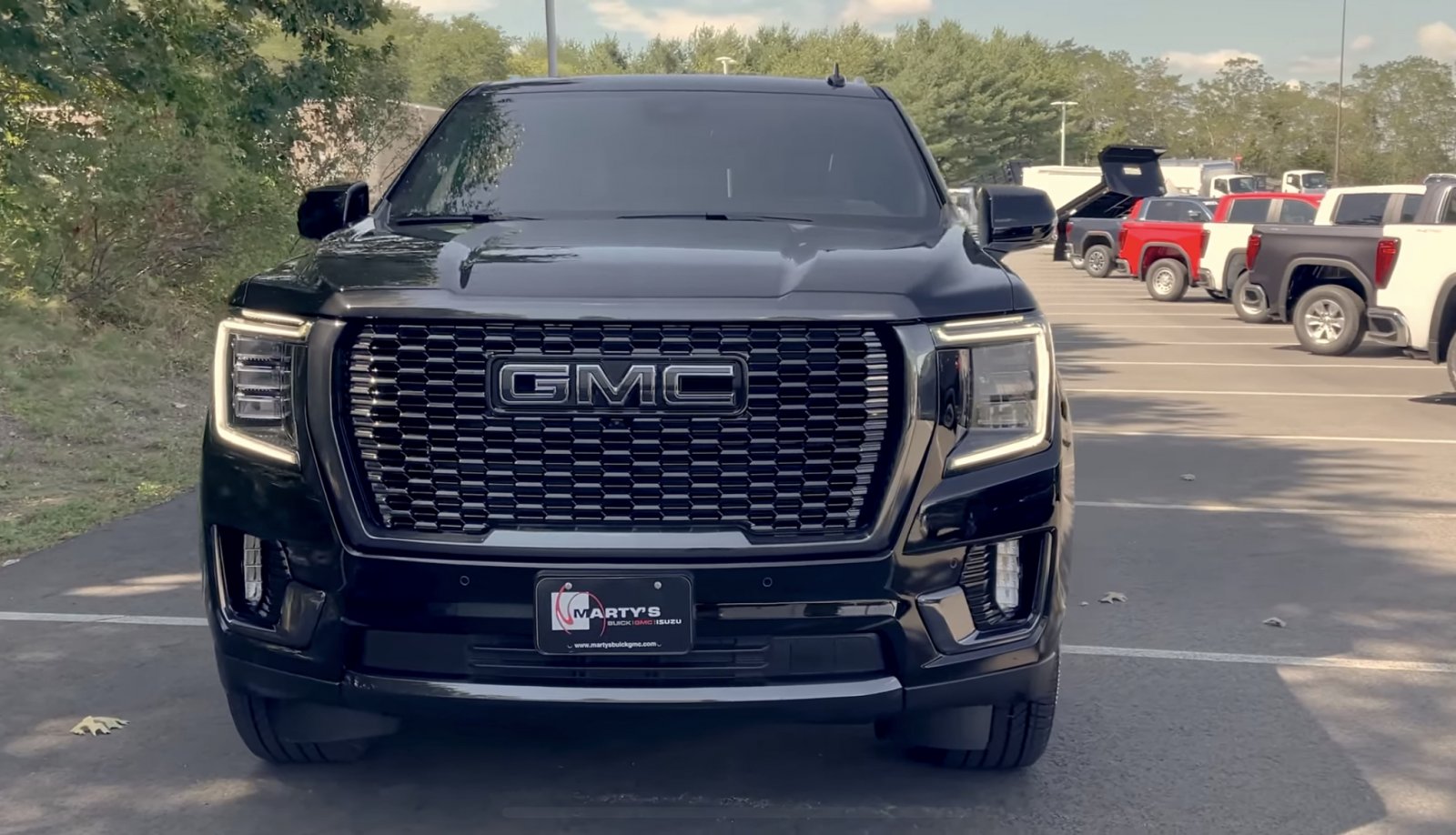

I am looking to swap out my stock 2023 Yukon SLT grille for this grille or something very similar. Does anyone happen to have a part number or can point me in the right direction? I believe it is optional for the GMC Denali Ultimate package. Thanks in advance.

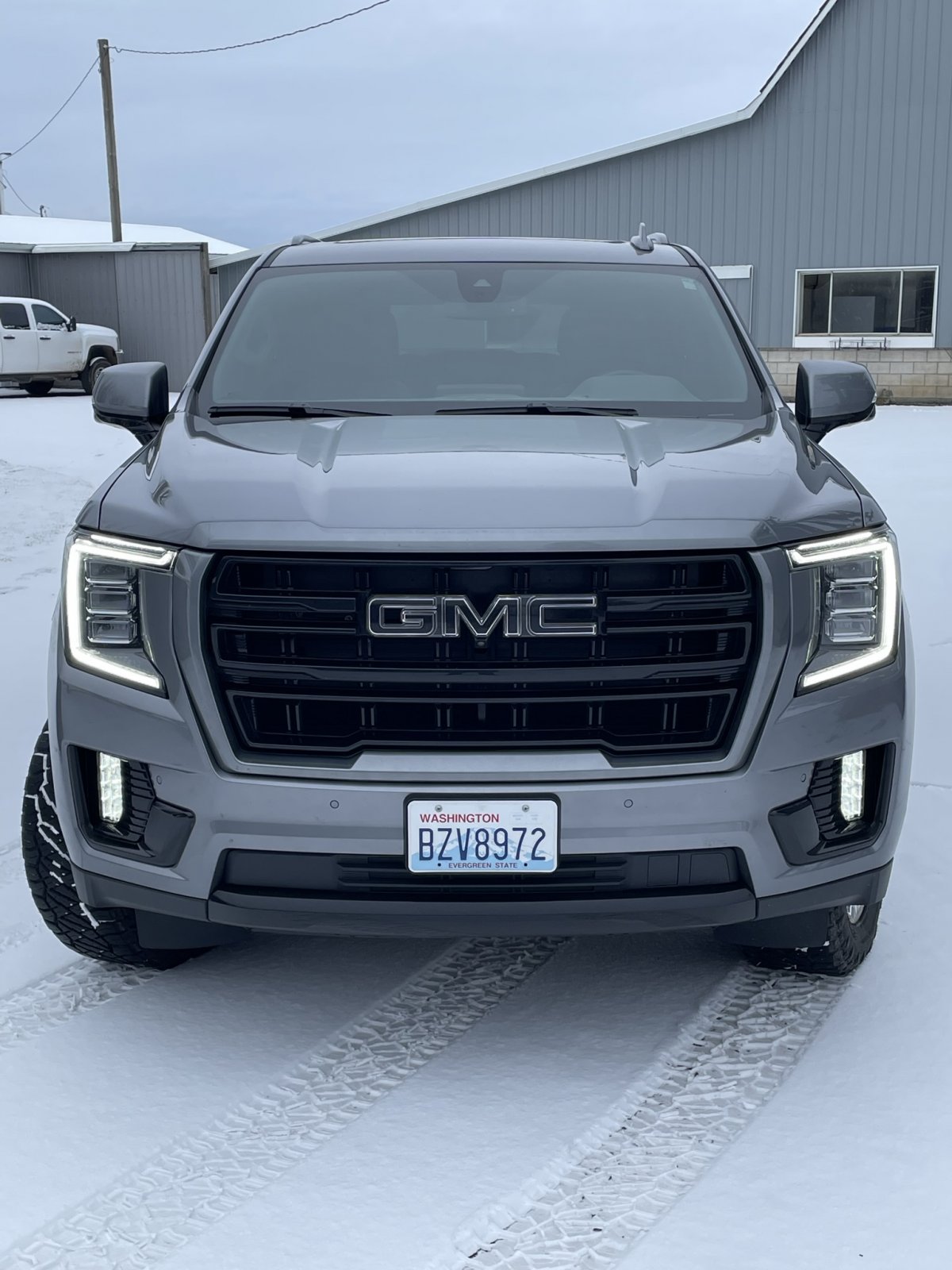

I know I’m probably in the minority here but I’m just not all that into the huge mesh Denali grill. Opted for the black with color matched surround on our slt and I think it looks fantastic. GM part with GM paint so it fits and looks like it came from the factory that way

I am looking to swap out my stock 2023 Yukon SLT grille for this grille or something very similar. Does anyone happen to have a part number or can point me in the right direction? I believe it is optional for the GMC Denali Ultimate package. Thanks in advance.View attachment 381775
That is the vader chrome grille from the Denali Ultimates. A guy here swapped in all of the vader chrome on their denali and listed part numbers here. Its more than just the grille (fog light bezels, lower valence, etc).

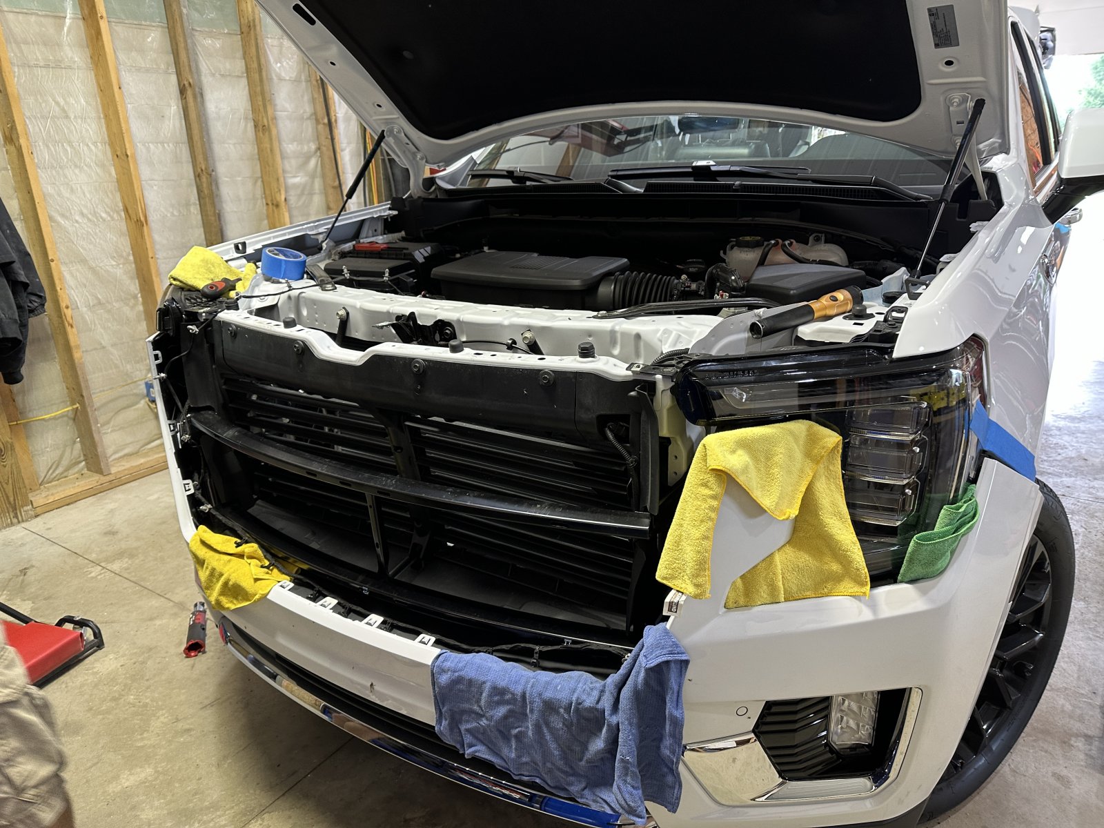

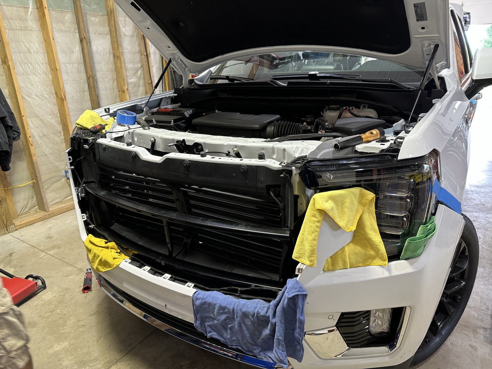

I love it!!! I have an SLT arriving any day and want to swap the grill. Can you send me the parts list? Below is what I’ve gathered so far. I’m not sure if the hood trim is correct. It says it only fits the Yukon.
Grill: 84835784
Front Hood Trim: 84820432
See this thread:
Gabeggg
Aug 28, 2023
Actually no i made the original one work with little modification.
I appreciate the response. So I'm clear, your saying if I buy the below GMC parts for my 2023 GMC SLT they won't fit?
* 84835784 - Vader Chrome Grill
* 84820432 - Vader Chrome Hood Trim
* 84710888 - Denali Camera (For mount)
I just don't really want to order these pieces and then be stuck with them because they don't fit.

Hello there, sorry if my response was little late i travel around the world for work don't always get chance to get on the site! Any how i cant vouche for any parts but i know that the SLT and Denali grill and hoot trim are interchangeable! Direct replacement. I purchased mine on Ebay it was lot cheaper then the genuine GM one. ( if you scroll up few postrs i posted the vender that i got it from paid $375 i think it was for both the grill and hood piece ) As far as the camera goes that's where the difference is, the way they mount. I was able to modify the original SLT housing by drilling two holes in the bracket that houses the camera and made it work. If you don't wanna tinker with that i think the Denali camera/bracket are around $110.
Hope this helps!

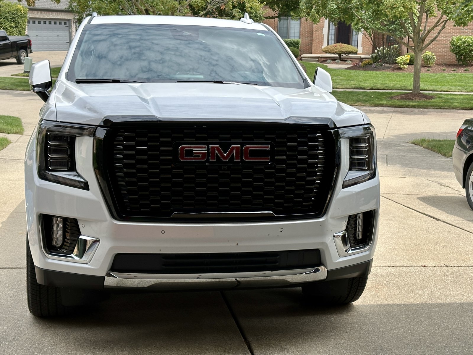

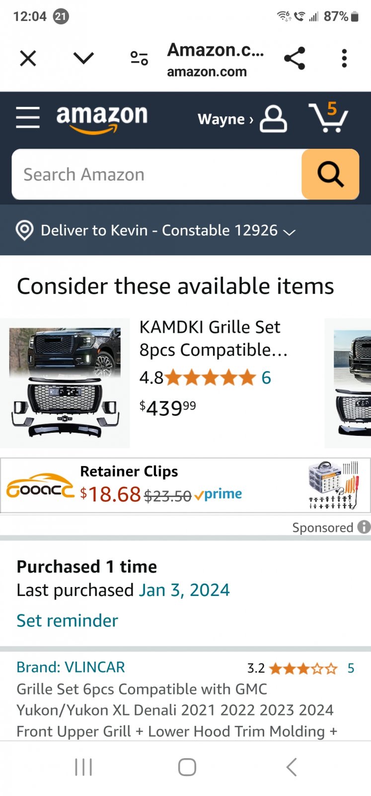

I swapped out all the front end on my denali gor this black kit. It looks great. DON'T WRAP---PAINT- not worth it. Amazon US. Abd from GM you will pay much, much more. I gad a body shop do the work

I’m looking to swap my 2024 Denali chrome grille & surround to black gloss. My wrap guy recommended just painting the chrome to gloss black for $750, and using touch up paint as needed to handle wear & tear. Not sure I’m liking that idea…also not liking the best option of VIP AutoAccessories charging $1750 for their kit. I’m on amazon looking at options such as what you recommended a year ago…so how has it held up for you? Glad you went that route? Any issues?
