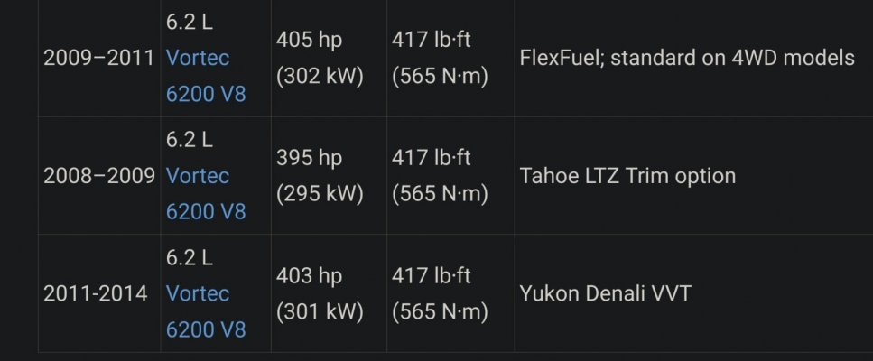

Regarding AFM - would you leave it on? A tune is high on my list of things to do, after air intake and exhaust (meaning I could turn AFM off then).
Is there a benefit to having the JL1 vs aftermarket trailer brake controller?
See attached - thinking these are the years/models I should be looking at.

I turned mine off with a tune simply because of the annoyance and yes there is less risk if it's not being utilized, some people can't feel it going to v4/v8 mode but I certainly can
the denali's and escalades all had the 6spd, not sure on any others I haven't done the research I wanted the 6.2 and didn't even bother looking at the 5.3's, had the 5.3 forever and kicked myself in the butt because of it

It's up to you. I would not look older than 2009, they don't have Bluetooth for your phone and those engines are not FlexFuel. There are E85 stations all over Palm Beach county, you can save a bundle running that stuff around town and switch to gas for when you need the range. 6.2s require high octane gas.
I've not owned an 800 but they are thought of very highly here, some who have had both, prefer the older ones because of comfort of seats and fit and finish.

All 6.2s are backed by the 6L80.
