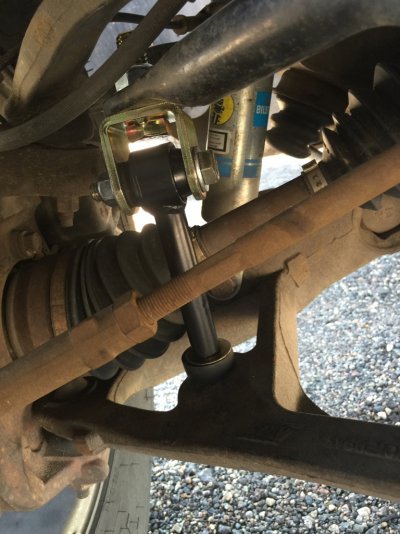

Have you installed your 2500/3500HD front sway bar links yet? If so, did you have to modify anything?? I'm getting ready to order them for my 02 z71. I like the fact they are 1" longer. I have 2.5" keys with bilstiens. The cognito's if I am understanding all this correctly come in stock height, then go up to 4", and so on....
I broke 2 sets of stock length links (6"). Installed the Cognito's and haven't had an issue since. Mine are the 7" ones. See installed pics above.
https://www.alligatorperformance.co...way-bar-end-link-kit-for-01-15-gm-2500hd-3500
