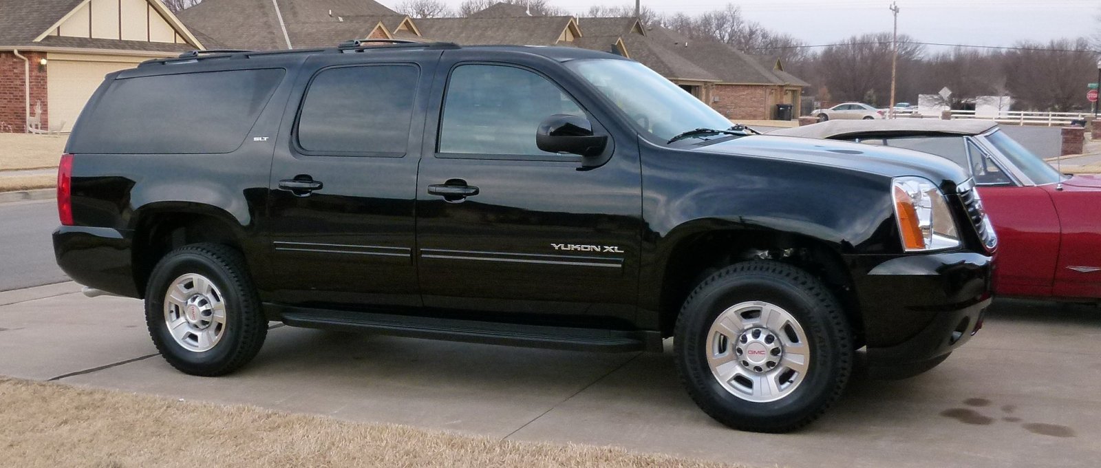

Lifts for 2500 Subs or Yukon XLs...what am I missing?
ARAMP1
Dec 27, 2010
64
51
Memphis, TN
When I look up lift kits and suspension pieces for my 2011 Yukon XL 2500, the choices seem very limited yet there are all kinds of options for the 2500 trucks. Are the front and rear suspensions so different that a truck kit (or parts) won't fit the SUV?
Matt_
Jul 10, 2016
445
485
Search for 2009. Most kits are shown as fitting up through 2010 because the 2500 series trucks changed suspension designs in 2011, however the 2500 series SUVs stayed the same until their last model year of 2013.
