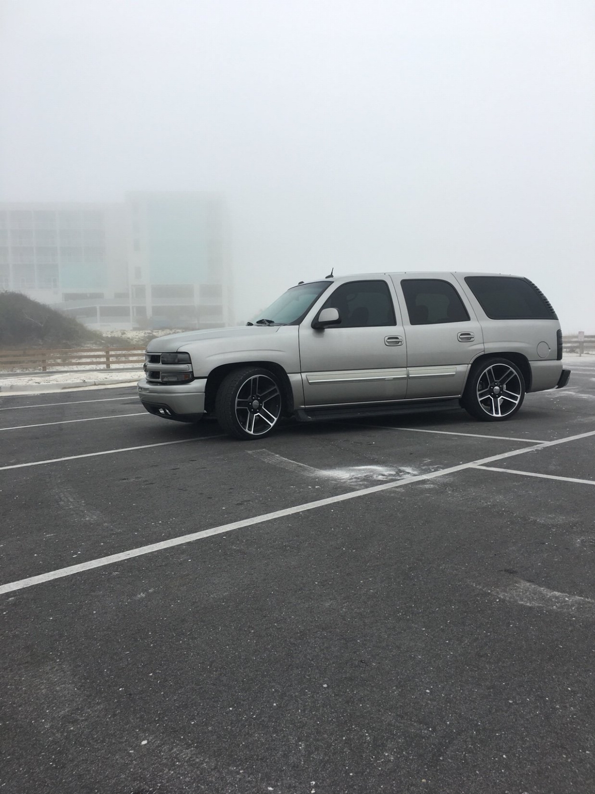

Well I know most people are against lifting 2wds but that’s what I have to work with. Is there anything I need to know ? I’m not wanting a monster lift kit. I’m just wanting it to look good on some 33-12.50- 22. It’s currently lowered right now but wanting a different look. Pic is currently what it looks like. Any info will be greatly appreciated!

Man I appreciate the quick response. I’m gonna check into that kit ASAP !

Thank y’all , I have decided to keep it like this and convert the front to coil overs at some point. Order new wheels also.
