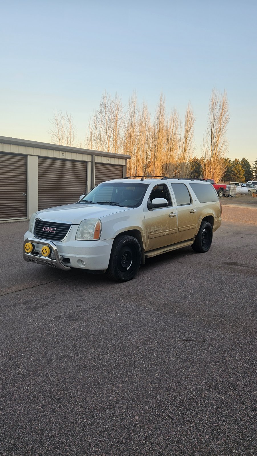

So i bought a set of 22" gm transport wheels and the tires on them are 275/70 which i think comes out a little bigger than a 33, what lift size should i get to clear my fender liner and my e brake i had to modify them and my e brake cable is ziptied to keep from rubbing

That’s a nice looking truck. Are you wanting to do a full on lift all the way around or just want your tires to clear?

just like them to clear an a little more because the roads around me a rough

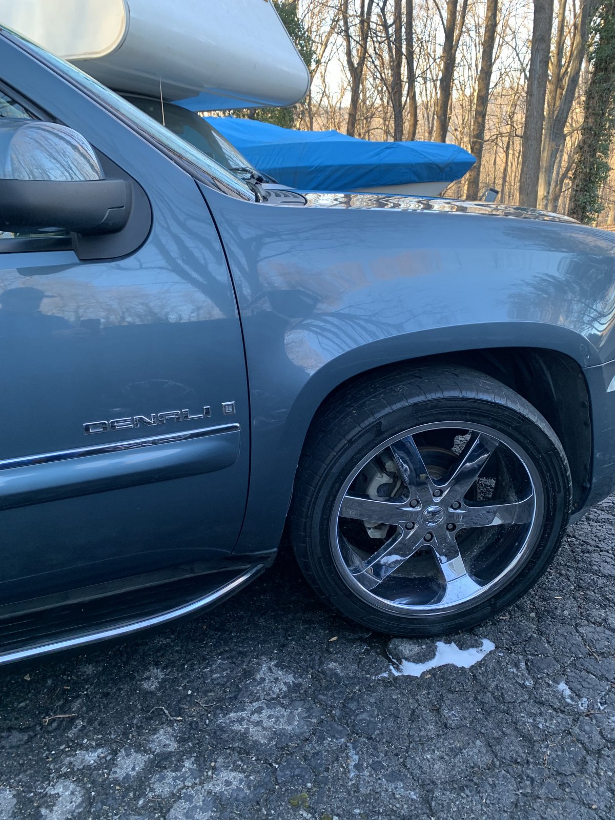

If they are a new setup, meaning you have your current setup try them on prior to lifting. As stated my U2’s had a fairly big offset and I ran 305/40 while being lowered 2” in front. I had to pull in the fender liner a little and trim a little but otherwise had no problem. Here’s a picture.
