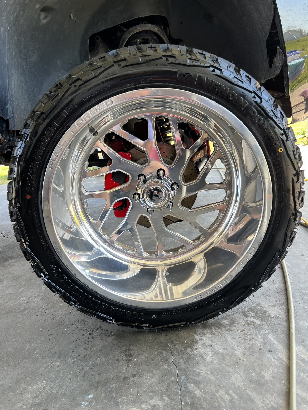

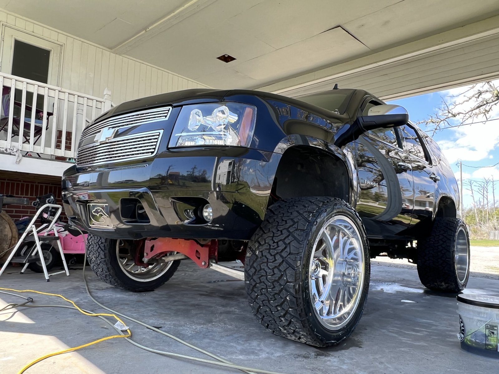

14 wide in any wheel and 33s if you don’t want to trim
If you don’t mind trimming some you can run 35s and 22x14s
I currently have 24x14 fuels and 35/15.50 venoms with around 8-8.5” of lift and after trimming the front and rear bumper and cab corner I can clear just about full lock
You can probably get away with 12 wide wheels with 35s but with that lift it’ll look funny imo but that’s coming from me. I have 14 wides on everything I own lol

that's a nice looking ride. Thank you for all the info. If I go with a 5 inch lift instead of the 7.5 and 14 inch wide wheels with 33 inch tires, do you think I'd have to trim anything at that point? Thank you again

Yea possibly but you should be good if you do have to trim it’ll be on the lower bumper valence or inner fender liner so it wouldn’t be noticeable or seen.
I trimmed my fender liner my inner cab corner and my front bumper
