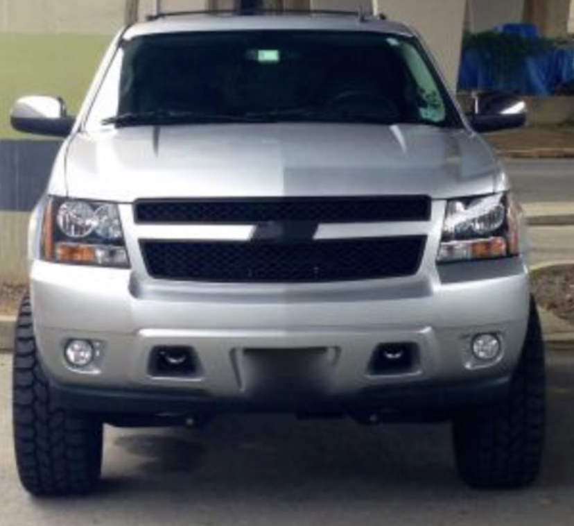

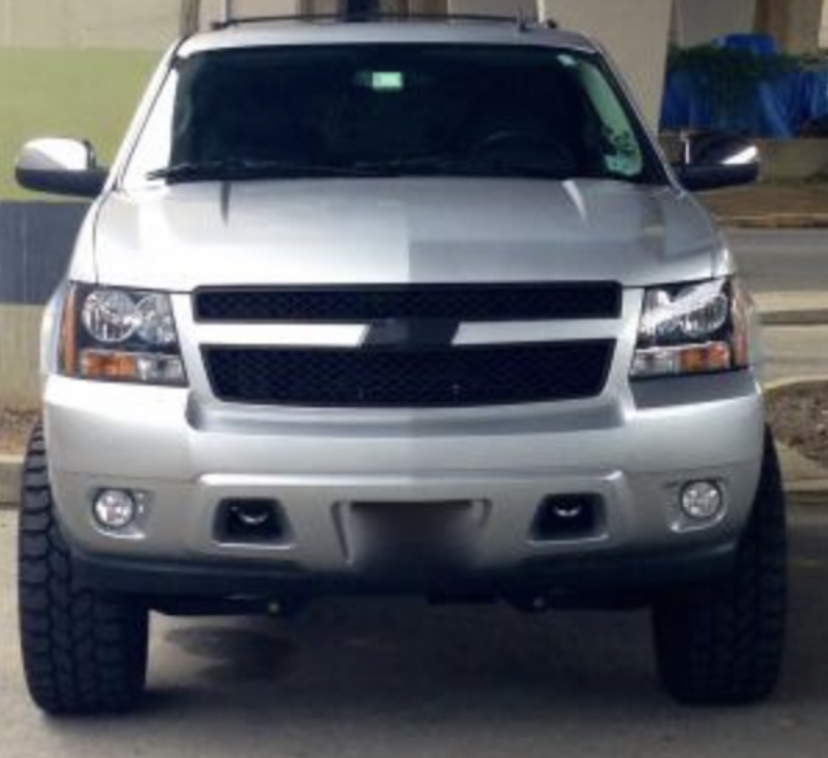

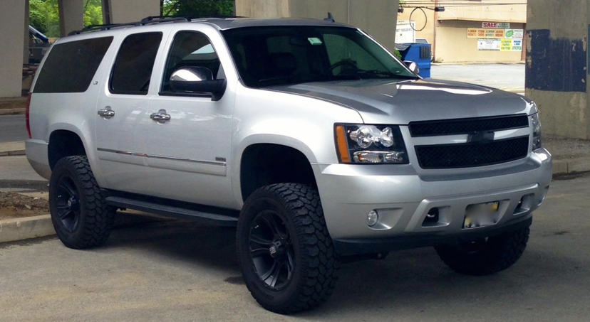

I really like the look of the Suburban in the pics I’ve attached. Has about the right “poke” for me. Would love to find pocket style flares that would work if I had wider tires.

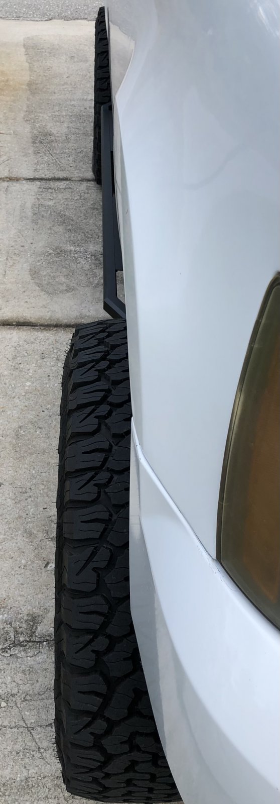

Those 285’s are about as narrow a 35” nominal tire as can be found. With a 9” wheel you’ll still have a significant amount of poke. Mine’s more than I like, and that’s on an 8” wheel.
have any pics?

Anyone have a guess as to what the offset is on the suburban pictured above? Just said 20” XDs witty 35” pro comps.

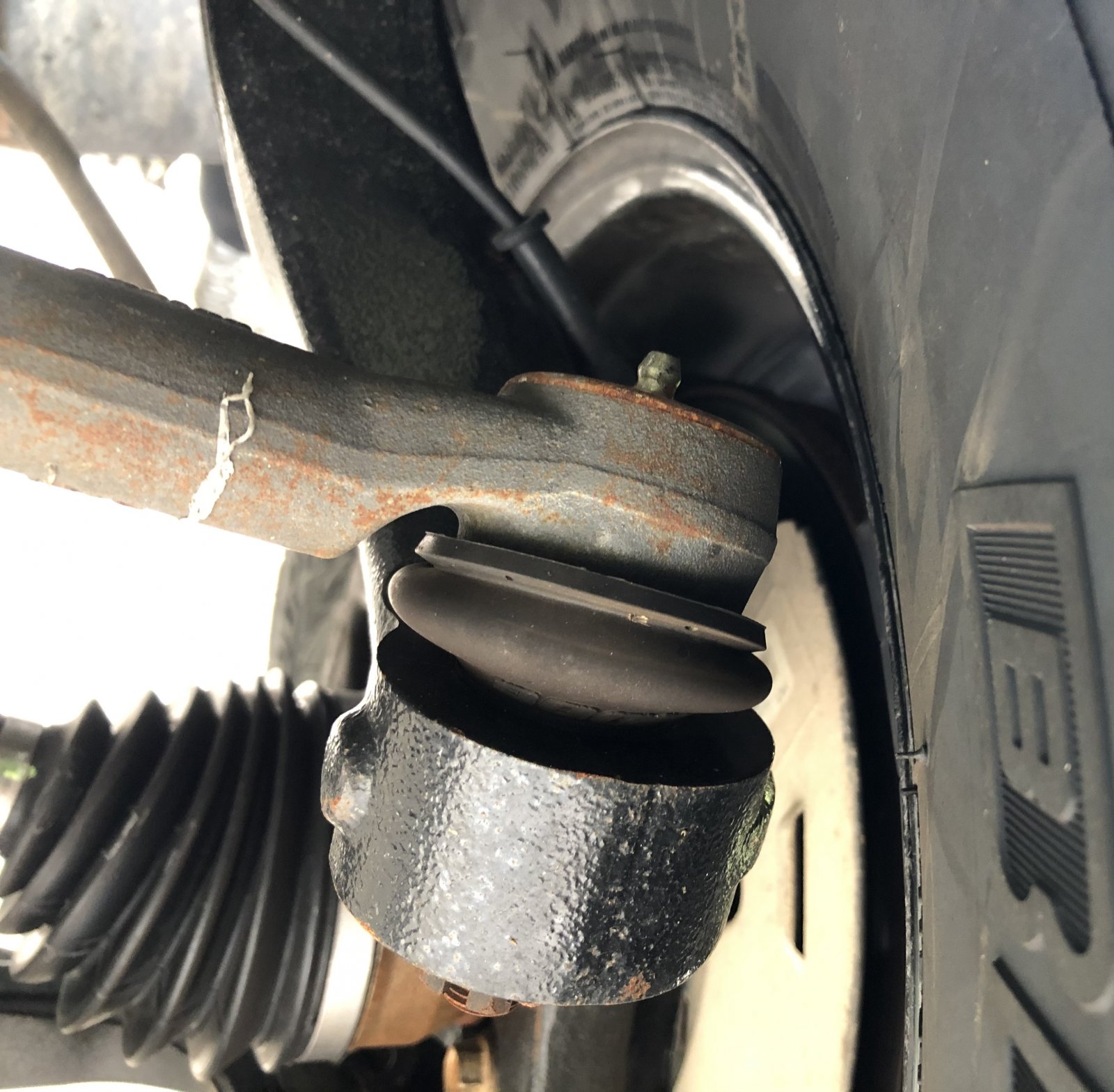

There’s just enough clearance to move inboard a half inch. So 4.75 BS would be the maximum inboard for this tire size on my lift. I’m sure 5” BS would be too much on mine, and contact the tie rod end.
