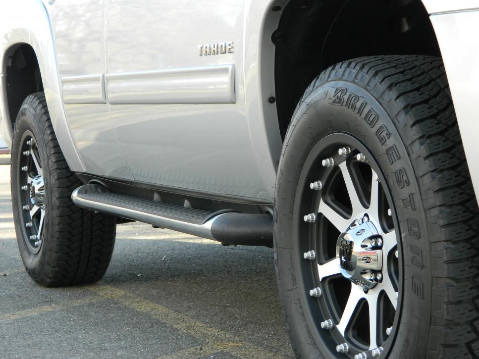

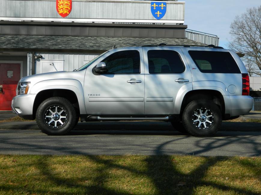

This is one I just did...Believe it or not, ...1.5" front leveling kit and 18x9 XD addicts, used the stock tires and the wheels made them look totally different

Thanks guys, great info and pic's. One last question, who should I have install the leveling kit, Chevy dealer or tire shop?
