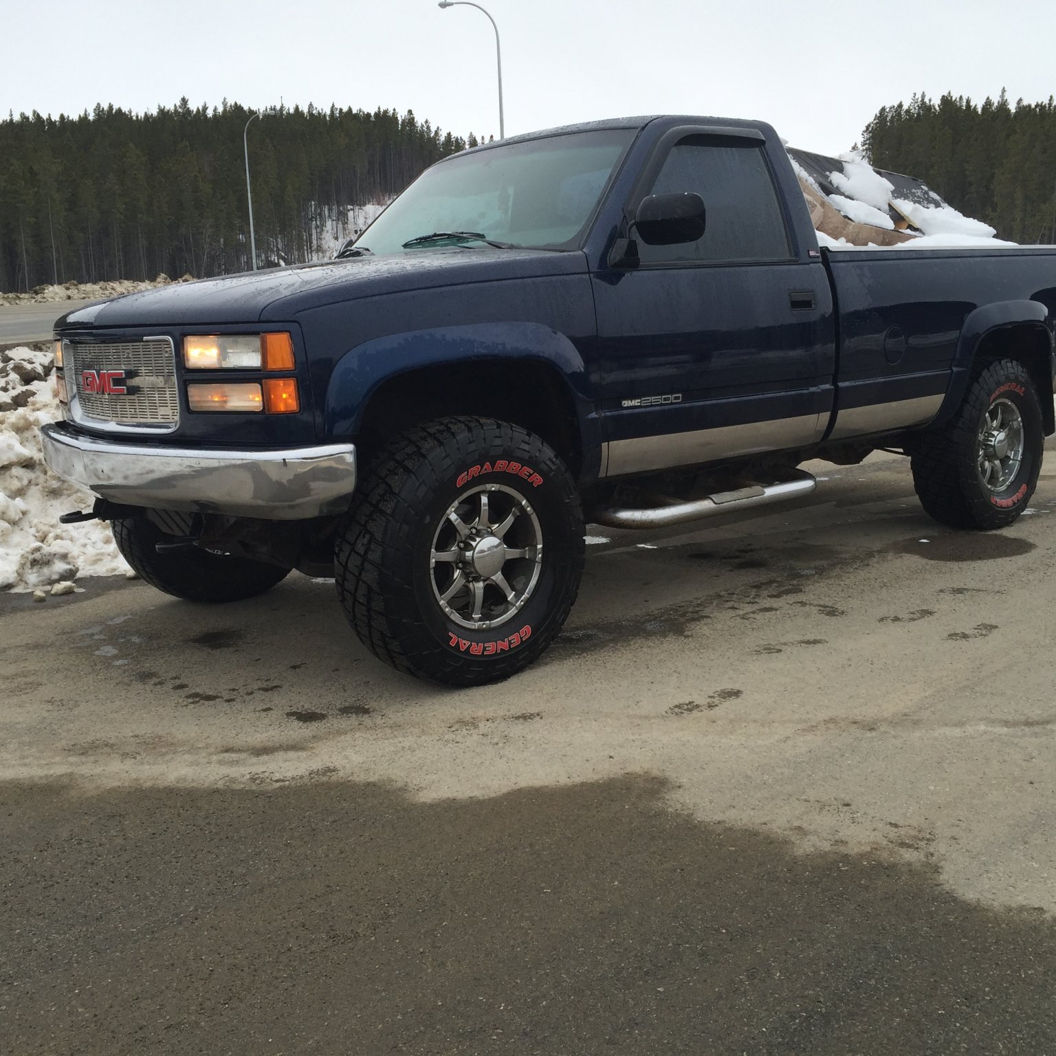

I run 33" red letter grabber's in the winter on the HOE, 10plys and 50psi. Rides like a lumber wagon.. but im used to it.. my other "summer "vehicle is a lumber wagon hehe

Nice looking truck!
