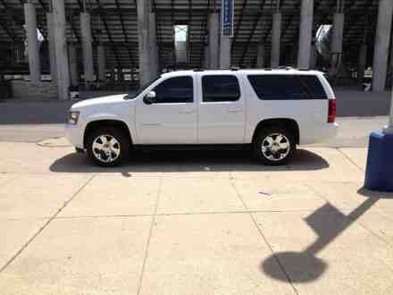

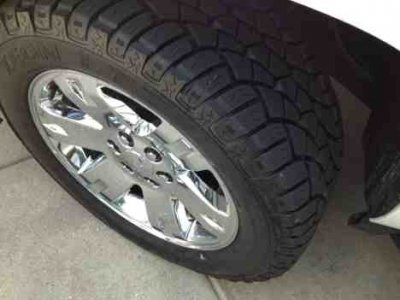

A couple pics of the new tires and wheels and the RC leveling kit...

Truck looks good, what model/size tires are those?
