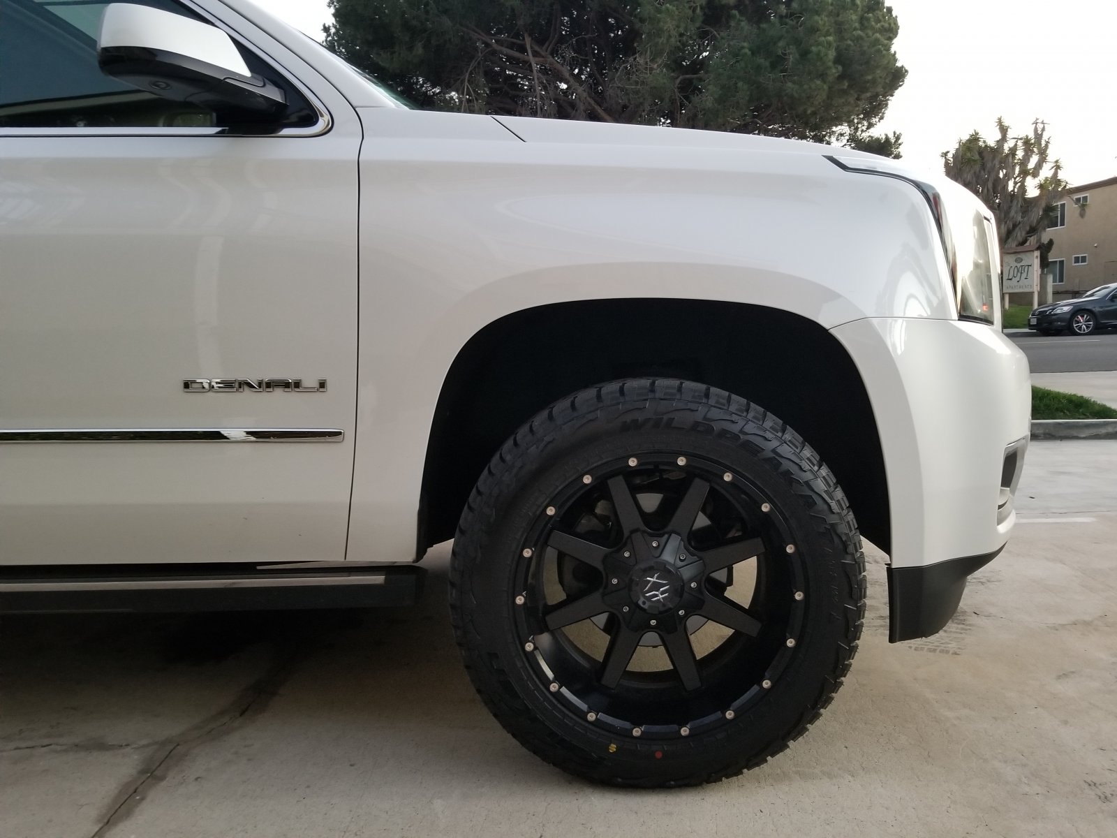

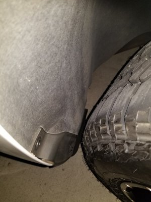

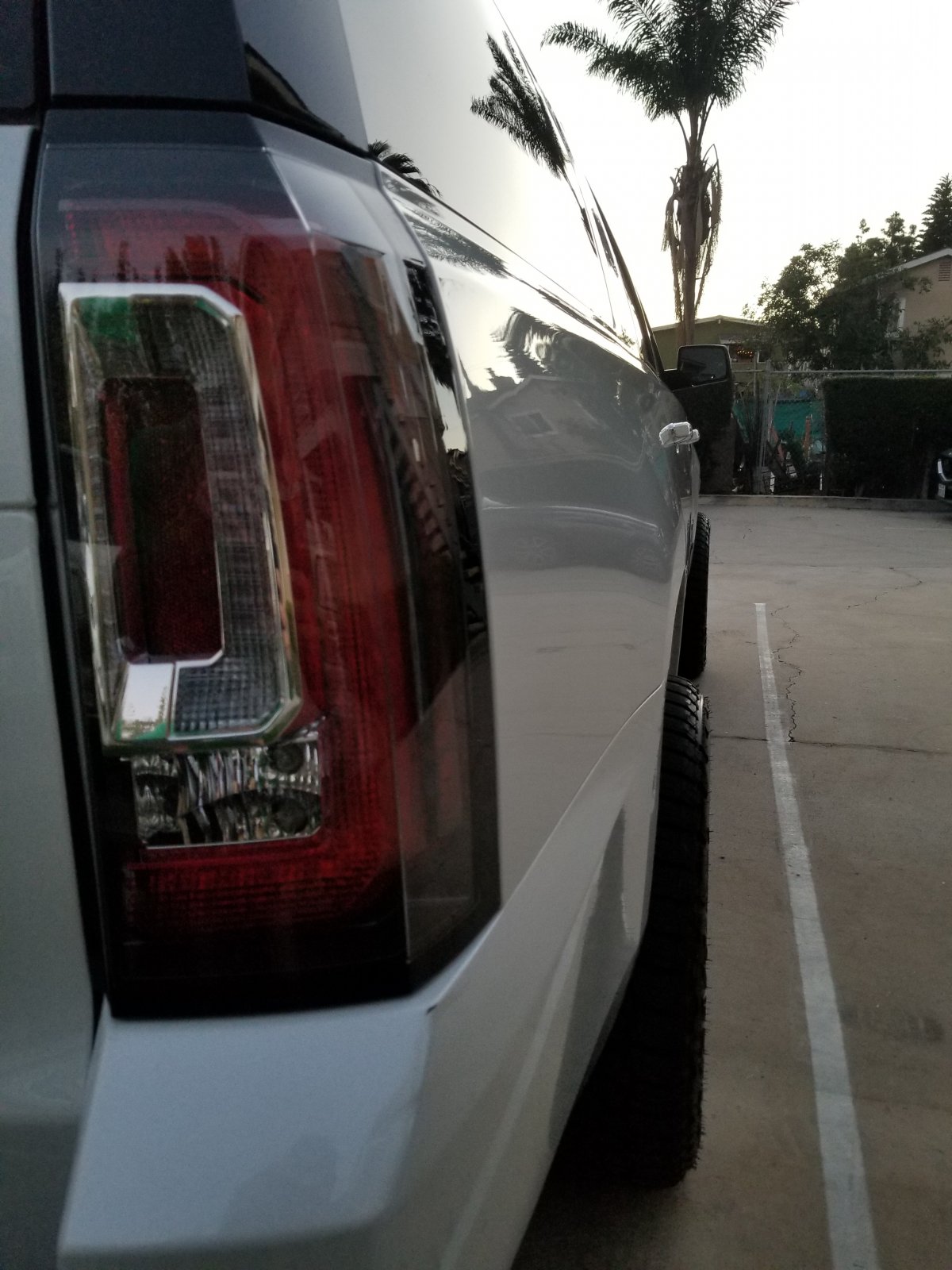

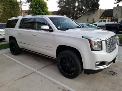

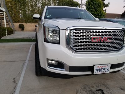

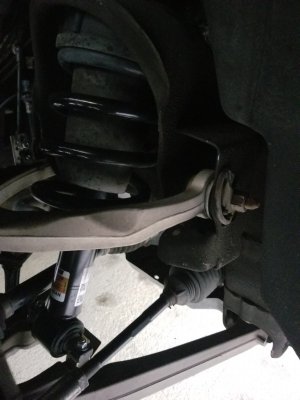

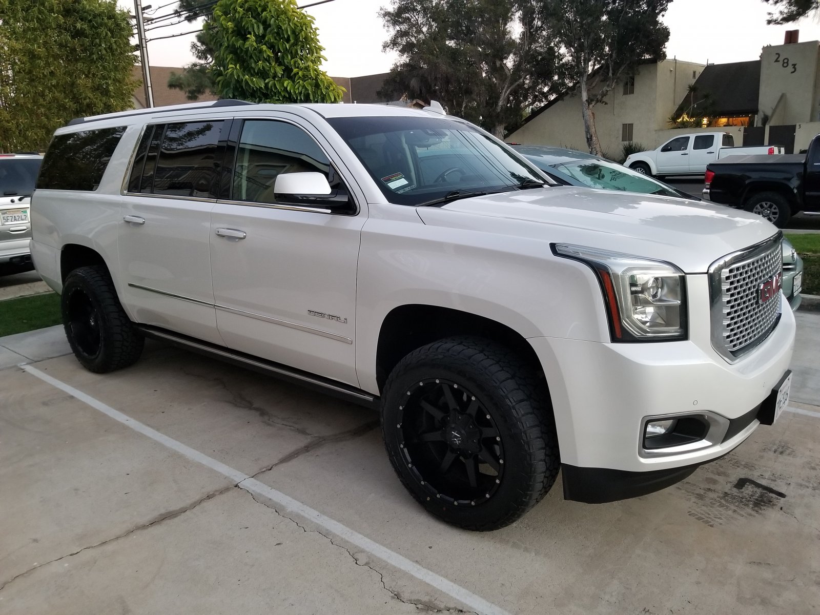

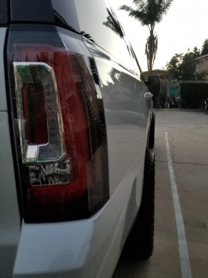

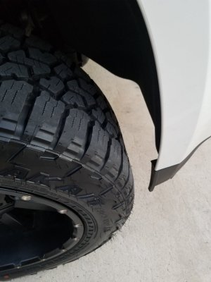

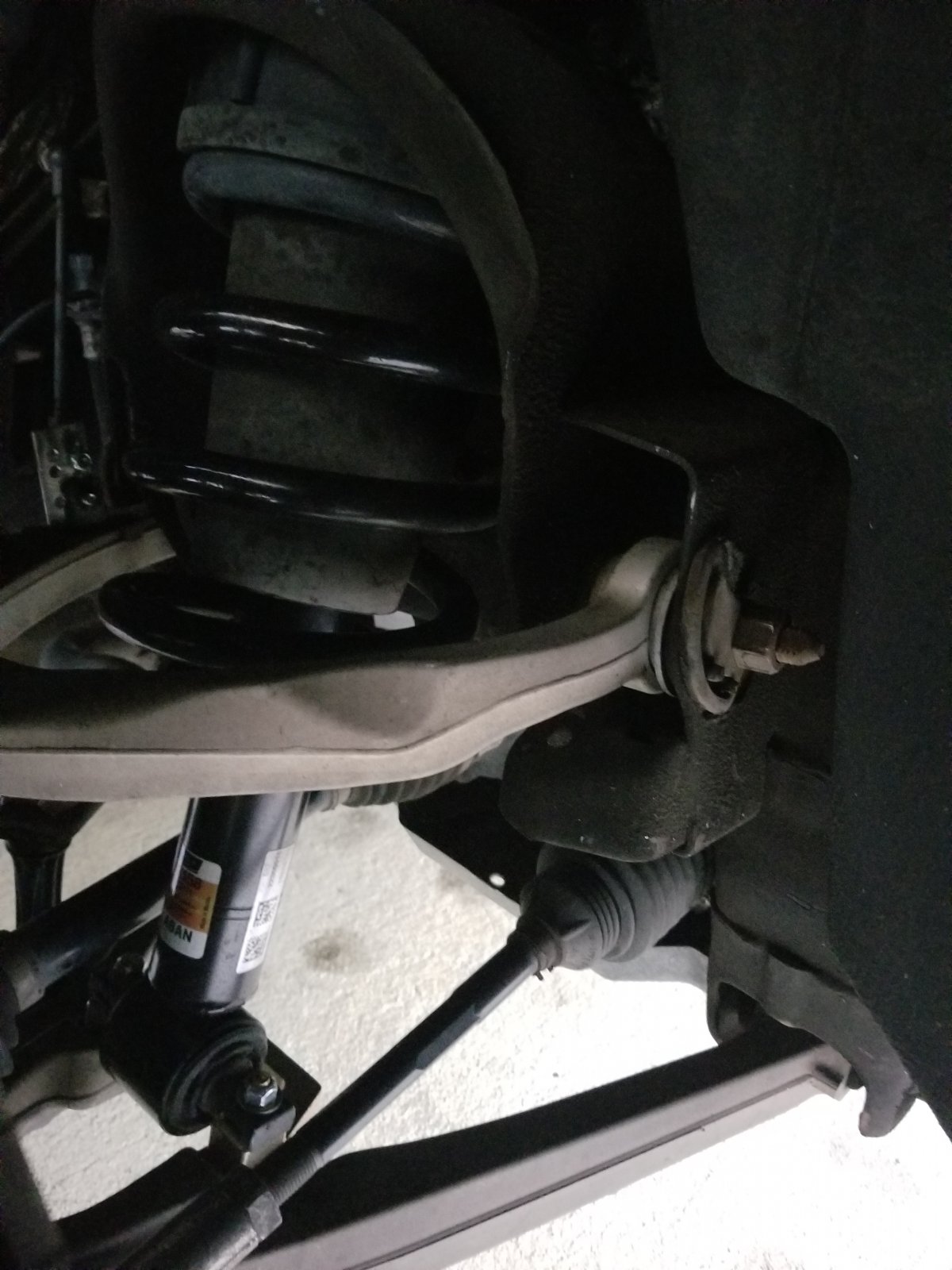

Here is some info on my set up. I love the way it looks and have NO rubbing.
2016 Yukon Denali XL
-suspensionmaxx 2" level in front (1.5" bottom block 2 disk spacer on top.)
-Stock rear
-20x10 et -24 wheels
-275/55 r20 Falken wildpeak at3's tires
I couldn't find any answers with anyone running this aggressive of a offset and not having a full lift kit so here are my results.
20210212_174319.jpg 20210212_174330.jpg 20210212_174341.jpg 20210212_174355.jpg 20210212_174414.jpg

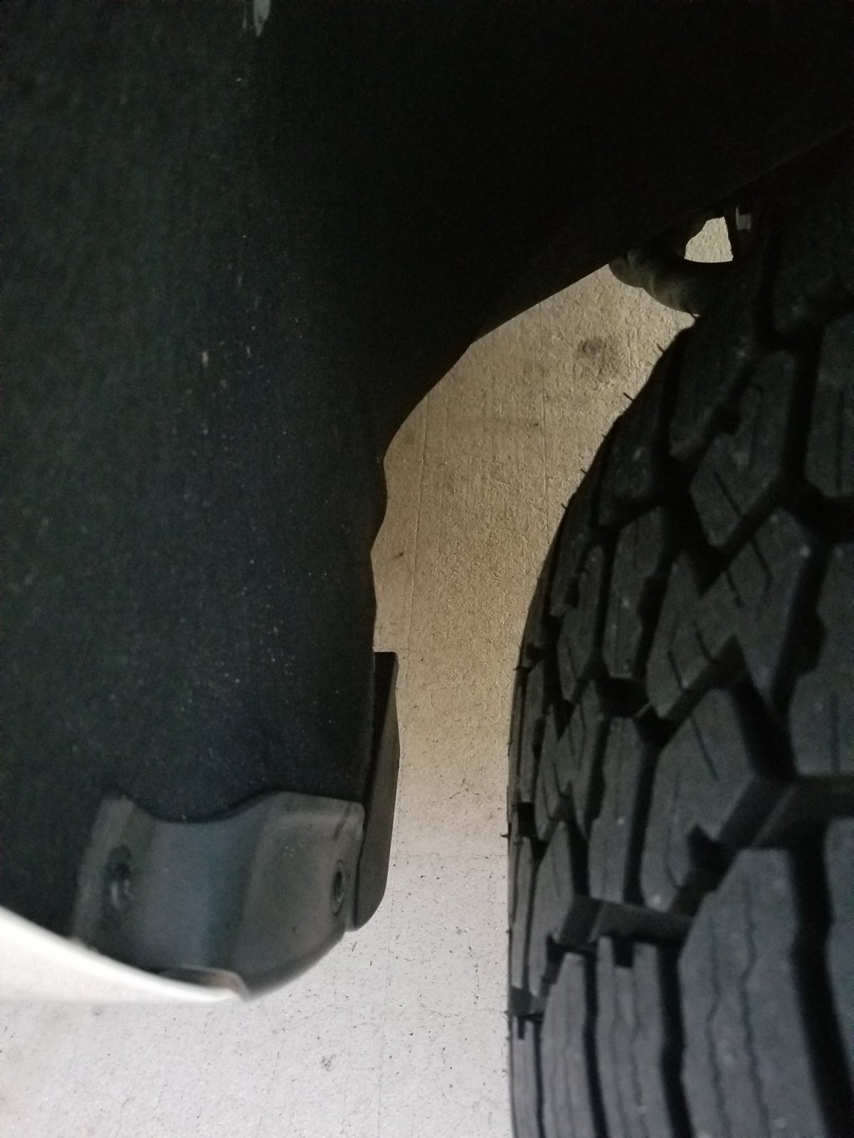

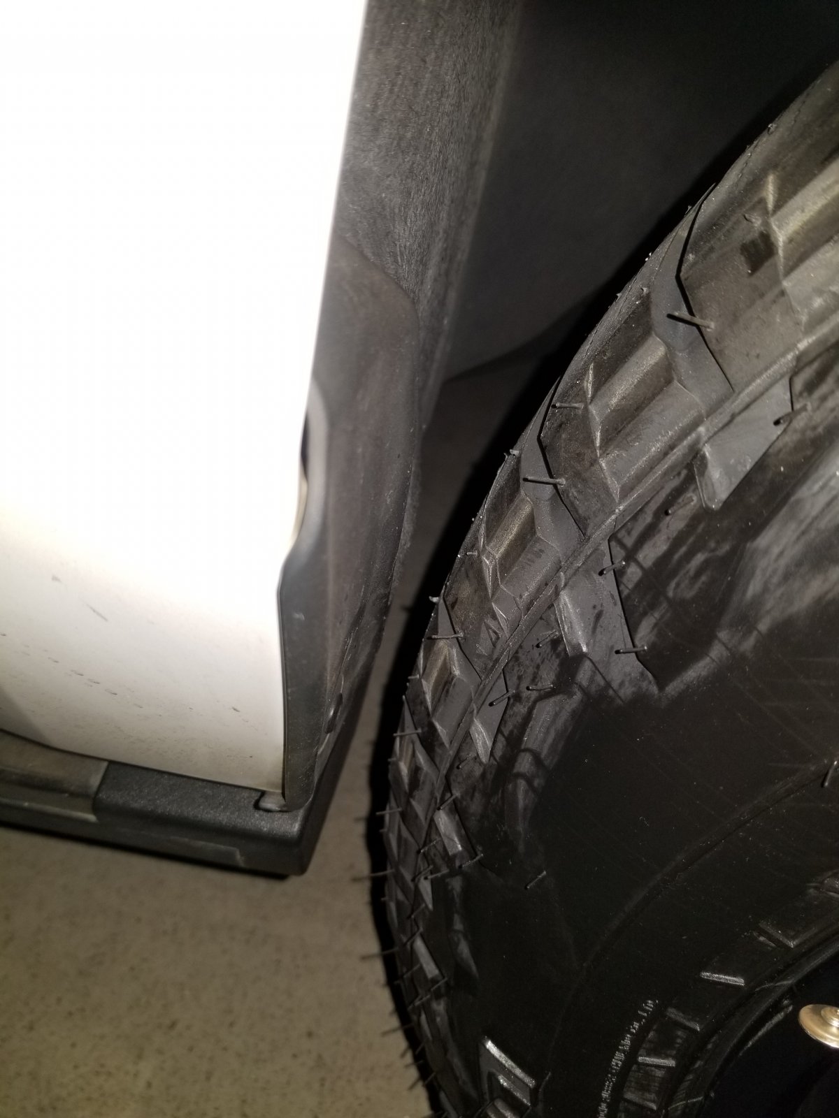

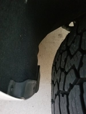

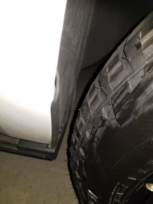

My main concern was clearing the factory power steps. Unlike the amp steps the factory ones go all the way to the fender well and can be a conflict spot. With the alignment at 3' of Caster there is NO rubbing and NO trimming needed. I hope this helps anyone looking for a level with aggressive fitment.
20210212_174400.jpg 20210211_181844.jpg 20210211_181839.jpg 20210212_174403.jpg
