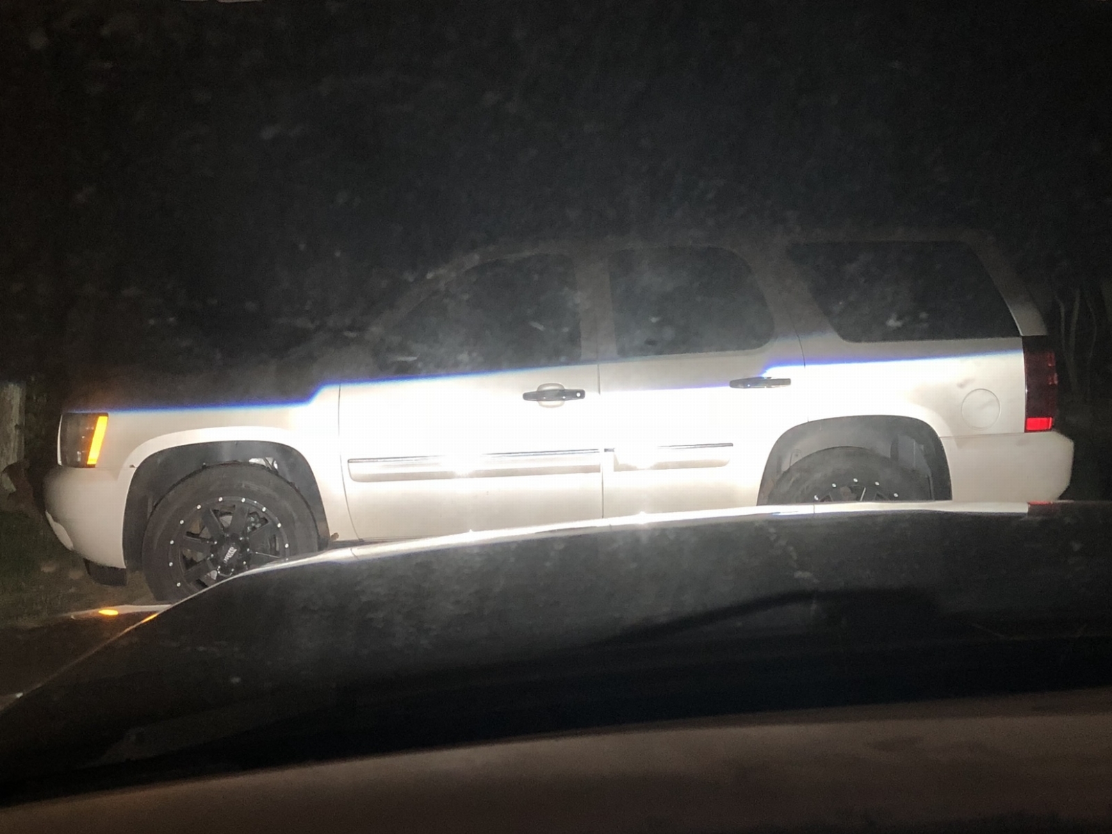

Just finished my mini h1 in 05 2500hd low beams. My cutoff looks good until the left starts to ride I feel like it could be a bad shield or me being off. I did notice I tried the silicon washer on the left side and not on right hopeful it’s bulb alignment any input?
Do you have more pics. Looks like it could bulb alignment have you seen the bulb shim page on hidplanet.com
https://www.hidplanet.com/forums/fo...0-how-to-shim-a-hid-bulb-for-proper-alignment
I haven’t read that, I will thank you.. I honestly haven’t touched it as it’s just a toy vehicle
but I did noticed that the left side may have a
bit of a hot spot. I believe that would lean towards bulb placement as well? I’ll try to get some photos of the lights against a wall
