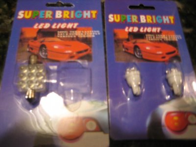

A follow-up since I started this....I found a great source on ebay --ushd.
ushd has had everything that I needed and at fantastic prices. I used 9 LED feston lamps for the interior dome lights, 2 in each and 1 in the cargo light; because I have a XL it took 7 of the 9 LED lamps.
For the puddle and license plate lamps I used T-10 also known as 194 lamps. The lamps I got from ushd for these applications was the 6 LED Super Bright White lamps. All the lamps used require paying attention to polorization....if they don't light just take them out and turn them 180 degrees and re-install and they should light right up.
In short I could not be happier with how this project turned out. The cost for everything was well under $50 including shipping.
I will try to post some pics in the next couple of days showing everything.

As promised I took some pics. I have a black cloth interior so it "absorbs" the light but I think you can still see the huge difference.
The last one is the drivers side puddle light
Here are the lamps I got from ushd.
