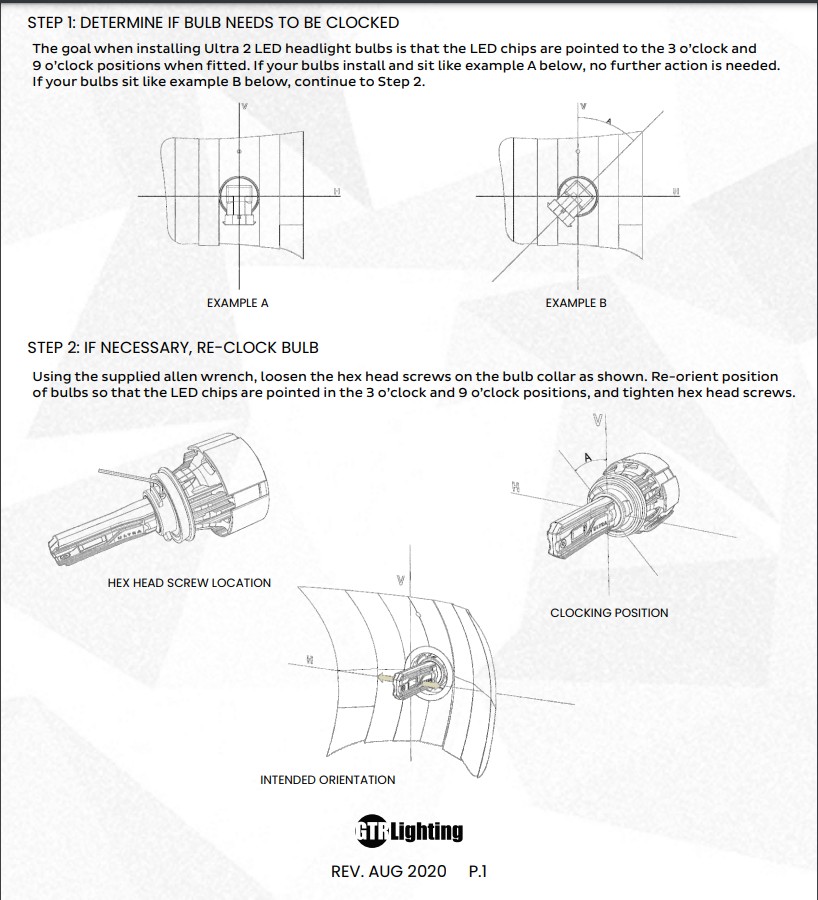

The choice of an LED lighting system MUST include LED assemblies that are rotationally adjustable. Otherwise, there is a good chance that you won't have the correct beam positioning. Also fan cooled LEDs will better dissipate the internal hear generated by the LEDs.
Don't cheap out, as you often get what you paid for (at best). I've used a couple of brands of LED systems, and I settled on GTR Ultra 2 LEDs. They are expensive, but they are guaranteed for the life.
The actual LED beam adjustment mechanism is different for different brands/models, but the instructions supplied with the LEDs (or an installation guide on their product web site) should guide you through the process.
Bottom line, the popsicle stick in the LED headlight holding the LED chips needs to be as close to vertical as possible, after installed and locked into place in the headlight housing, with the LED chips pointing to the 3 o'clock and 9 o'clock positions. The photo of the guide below, while not for your specific brand/model, will give you a visual sense of how these LED headlights need to be positioned in a correct alignment within the headlight housing.

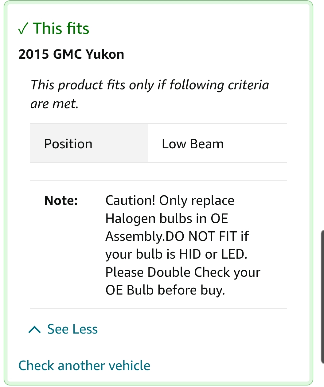

When I click on that link I see the following which makes me apprehensive because the HIDs and LEDs are new to me and there are so many varying opinions on retrofitting.
If that makes you nervous then for sure don’t read your owners manual about replacing bulbs with LED lighting…
Your ‘15 Yukon Denali has factory HIDs for low beams. There’s an OEM OSRAM 35W ballast and OEM OSRAM D3S bulb.
There are different considerations when converting from HID to LED vs the factory halogen low beam projector guys (Tahoe/Suburban LS & LT models and Yukon non-Denali models) dropping in H11 LED bulbs into their low beams.
It’s doable. There are D series LED bulbs out there. You’d need a D3S bulb. I’m just not 100% clear on how they react with the ballast. I guess that’s the power source, but it’s only putting out 35W. Some of the super bright LED bulbs coming out are 45W, 50W, and 55W bulbs.
