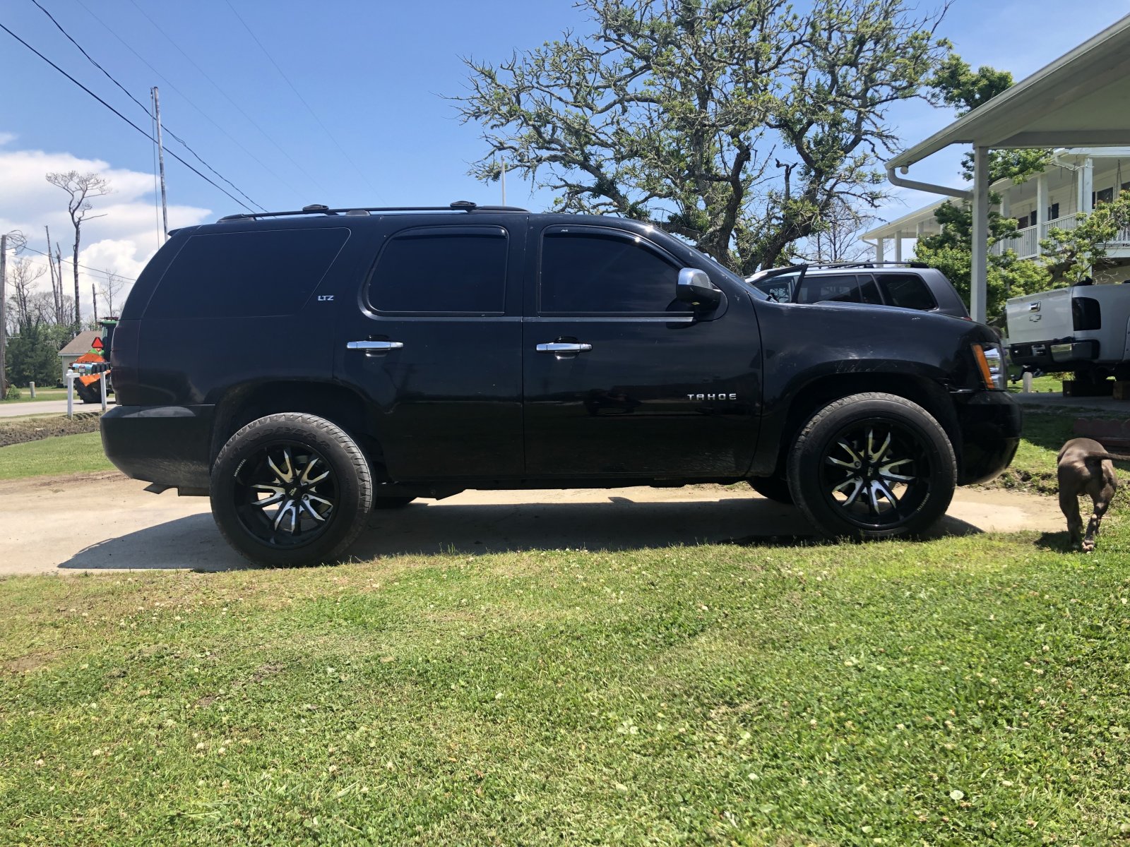

When my Tahoe was “lowered” I was able to clear 20x12 wheels with 275 streets
When I upgraded to 33/12.50 nittos I had to add a 2” leveling kit to clear at full lock
Pic with the 33s and 2” leveling kit
Sorry I don’t have any pics on stock wheels.
I did run some gmc replica 24s with 33/12.50s and also a set of kmc 24s with 33s and had PLENTY of clearance I could’ve easily stepped up to 35s if if not even 37s if I did a 3-3.5” leveling kit
I’ve had plenty of friends run stocks with 35s and nothing more then a 2” leveling kit
