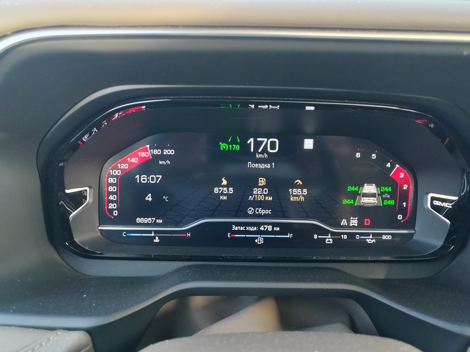

The DFM deactivator does not affect oil consumption in any way. One of the reasons for oil consumption is a leak in the sealant on the valve cover, approximately 1 inch long; since 2024, corrected valve covers have been introduced. Again, oil consumption occurs when you drive actively, pressing the gas pedal or quickly on the highway. There is no oil consumption in a quiet city driving mode.
I start to lose oil at about 2,500 miles, and I add about 0.5 quarts. And then every 600-650 miles, another 0.5 quarts. So over a 7,000-7,500 mile period between oil changes, I add about 4 quarts. And I don't worry about it. But I just drive fast, really fast. My highway driving is 95-100 mph.

We have speed limits of course :). But we have built great highways where the speed limit is 130 km/h or 81 miles per hour. But we drive on these highways as fast as the car allows. For example, in my previous Mercedes GLS I drove the distance between Moscow and St. Petersburg, 630 km, in 3 hours 45 minutes, with an average speed of 168 km/h or 105 mph average speed for the entire distance. I was driving 220-240 km/h most of the time, that's 150 mph for almost 4 hours)
As for the Yukon, I drove it 675 km at an average speed of 155 km/h, moving almost the entire time on cruise control at a speed of 170 km/h.
The point is simple. Fines and cameras are not about safety, they are about government revenue. And here they realized that it is easier to build a cool, high-quality highway and not install cameras so that people move quickly between cities, than to collect fines from this highway. Again, the fine for driving at 170 km/h, where the limit is 130 km/h, is about 5-6 dollars. Even if you get 3-5 such fines for a vacation trip, you treat it as an extra charge for driving on the roads)))
